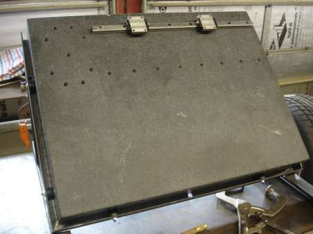

    I started with a 18x24x3 Granite surface plate. I drilled half way through from the top and then half from the bottom. All the components will be bolted down rather than using epoxied inserts.

    i did use a water swivel. you can see it in the 3rd and 4th pictures. i drilled one hole trying to stop the spray with rags and wood blocks. after that i made the spray shields shown the in the picture. there are two types of spray that i found. when you first bring the drill down to the surface of the granite with the water flowing the water sprays out horizontally. the two "C" shaped pieces fit around the water swivel to stop this. the second spray happens when you have the hole started. the water sprays out of the hole vertically and hits the bottom of the water swivel and gets every where. i put the cylindrical piece of sheet metal around the water swivel to contain this spray. after i had these pieces in place i could drill with next to no water spray.

    the second image should give you an idea what is going to happen. headstock will go on the left.

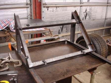

    Finally some progress. Got some tube for the stand and have that tacked together. Started machining the spacer that holds the headstock off the granite and will hold the Z stepper and ball screw.
