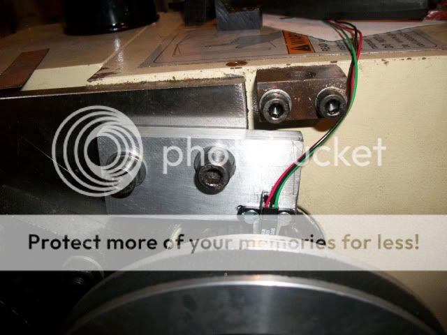

    Default SWING-ARM AND SENSOR INSTALLATION

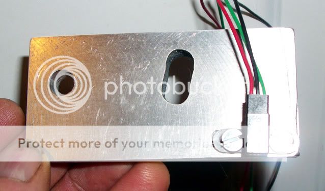

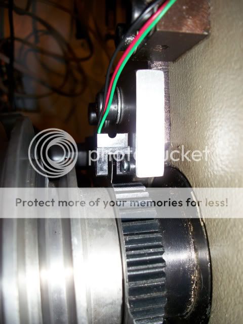

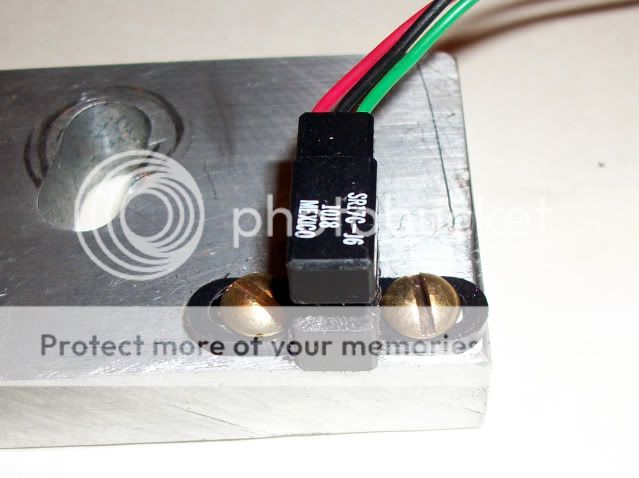

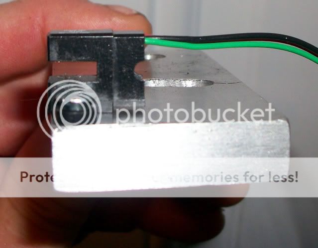

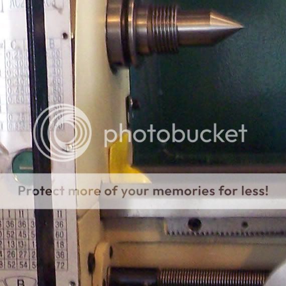

    Here is the finished swing-arm, with HE sensor attached:
    I used 6-32 x 1/2 flat head screws because that's what was on hand. They will be replaced with brass or aluminum machine screws, (non magnetic) and Loctite.
    Swing-arm & sensor installed onto lathe:
    Sensor/vane alignment:
    The wiring will be fed thru a hole in the headstock.

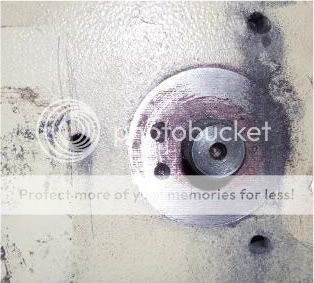

    Mar 2008
    3655

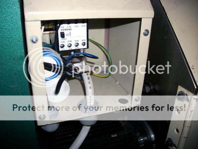

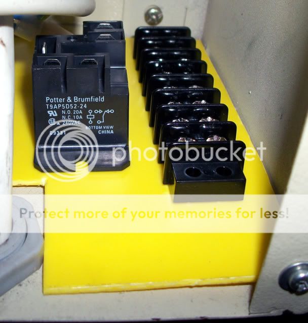

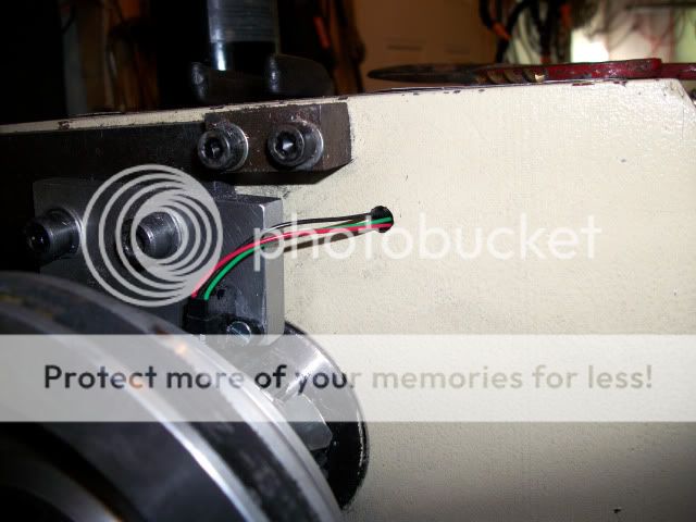

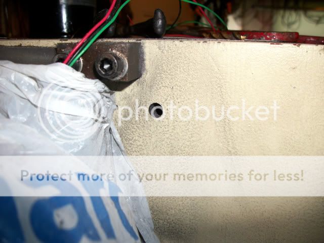

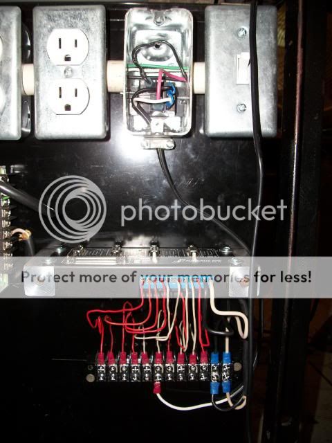

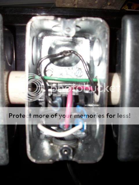

    Hole for wiring drilled. Plastic is to keep cast iron dust away from sensor:
    The wires will eventually be heat-shrinked and lead to this electrical box:
    Where the motor control relay, terminal strip and 24V Voltage divider will reside:
    By using a SPDT relay, manual control of motor is retained.
    CR.

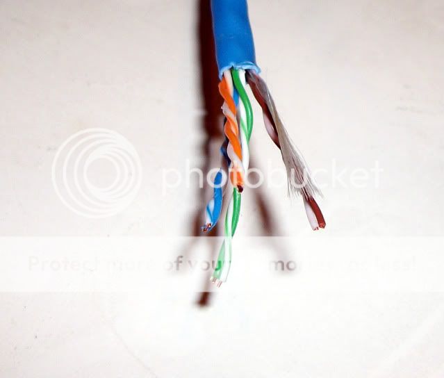

    Got the brass non-magnetic screws for the threading sensor:
    And this 24 gauge CAT-5 quad twisted pair wire for wiring up the electrical box:
    This was supposed to have been SHIELDED/stranded wire, but apparently the salesman lied. The cable must carry +/- 48V, plus a relay output, plus the sensor input, plus the Estop wire. The solid wire is probably OK, since there will be no flexing. Only time will tell if the lack of shielding will cause problems.

    The non-shielded cable is causing a wiring change. I WAS going to run 48V to the box and then Voltage divide that down to 24V. The Sensor wire leading down to G540 is the only PULSING wire. In order to cancel out that pulse, I will Keep the 24V divider close to G540 and run 2 separate 24V wires to the electrical box: One for the relay and the other paired with the sensor input. Hopefully, this opposite flowing electricity within the twisted pair will cancel the pulsing magnetic field, and eliminate any crosstalk.
    CR.

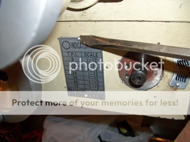

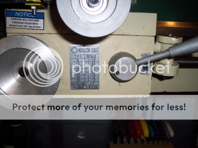

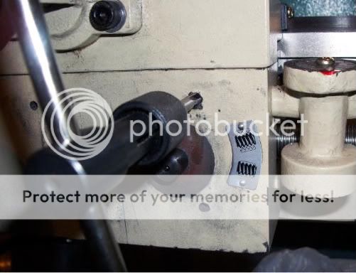

    Time to consider the X motor mounting:

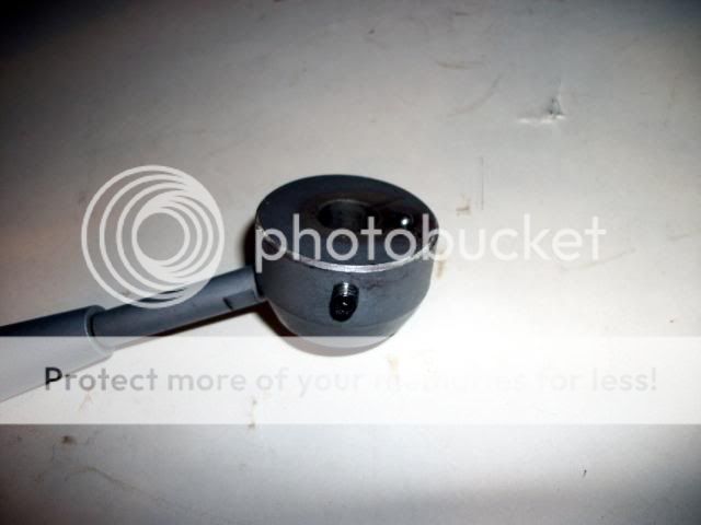

    This handle must be removed. There is a set screw underneath, and a ball bearing inside. First, set the half nut friction to optimum:
    There is not enough room behind the X shaft for the full length of the motor:
    I must either cut off the rear shaft, or cut a slot into the apron. If I was going to cut off the shaft, I would first drill and place a plastic shield to keep steel dust out of the motor, then use a cutting disk. I opted though, to cut a slot into the apron.
    This label is in the way:
    CR.

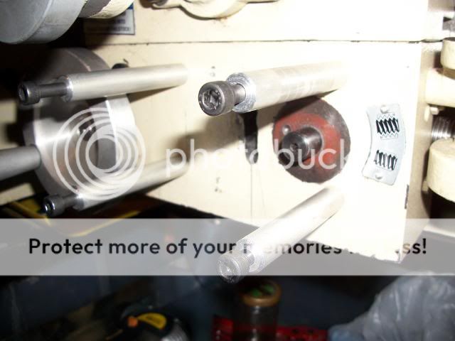

    3655

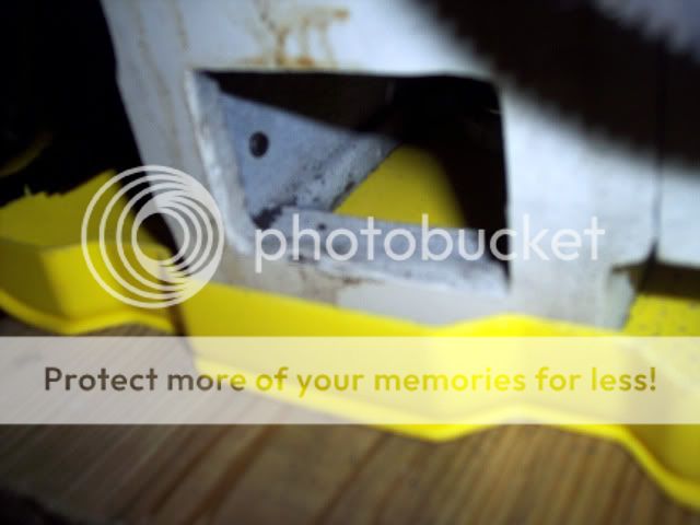

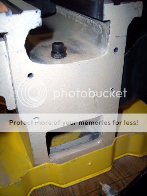

    Let's drill some holes and a slot. Slot starts with a center hole:
    Two more holes are added:
    Holes are blended together with round file and a slot is born:
    WARNING: THE Z LEAD SCREW IS BEHIND THESE HOLES. PUT A PIECE OF WOOD BEHIND TO PROTECT THE SCREW WHEN DRILLING.
    CR.
    http://crevicereamer.com
    Too many PMs. Email me to my name plus At A O L dot com.

    Registered Crevice Reamer's Avatar
    Mar 2008
    3655
    Now to tap some holes. The apron is fairly soft cast iron, but be careful. This is no time to break a tap:
    And then test-install some standoffs and long bolts:
    CR.

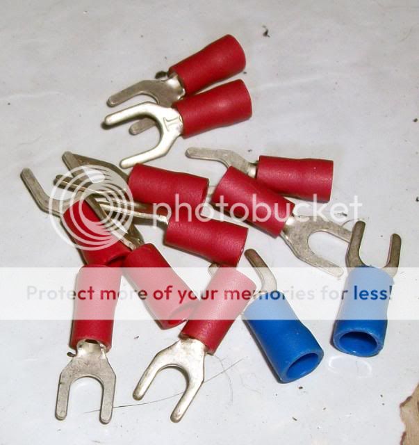

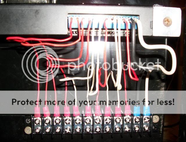

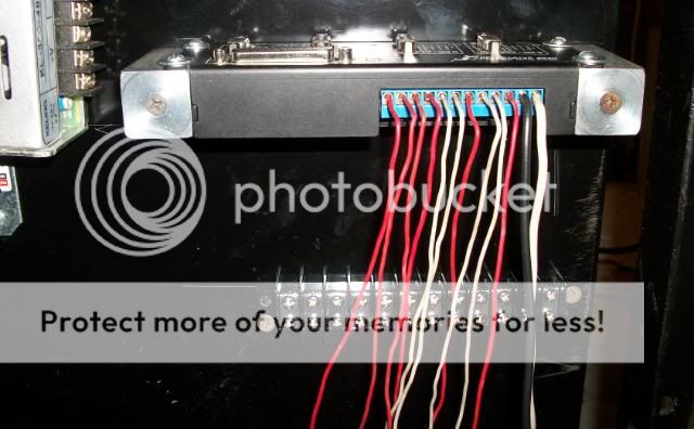

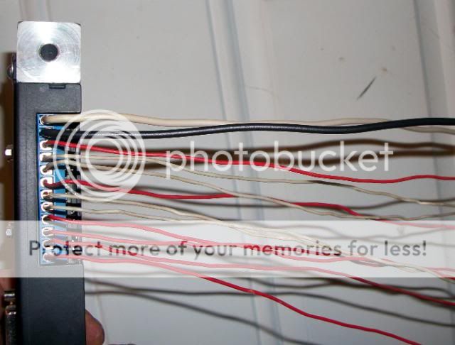

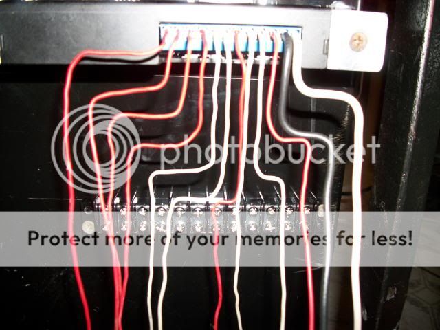

    Let's wire up the G540, with solid copper wire. For the power connections I'm using 14 gauge house wire:
    The wires will be "quick disconnect" connected to the 12 position terminal strip with these slide terminals:
    CR.

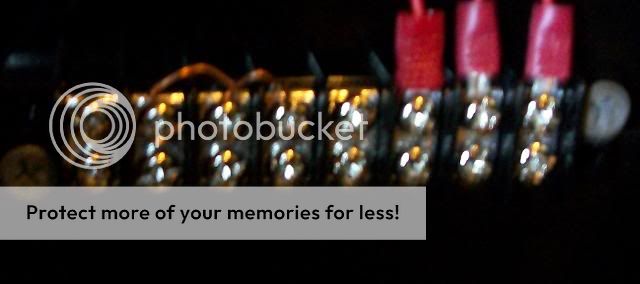

  12. #72
    Mar 2008
    3655

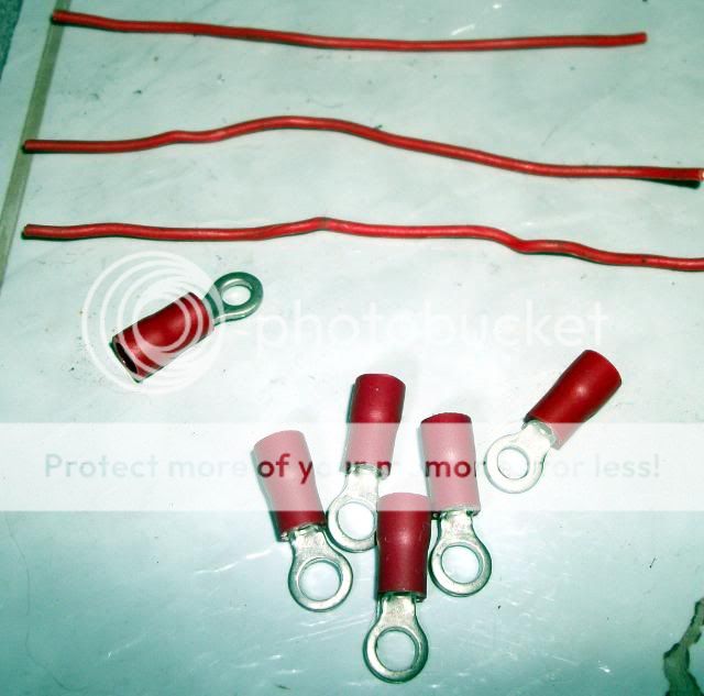

    I use Vise Grips for crimping terminals. Once set not-too-loose and not-too-tight they crimp perfectly each time:
    CR.

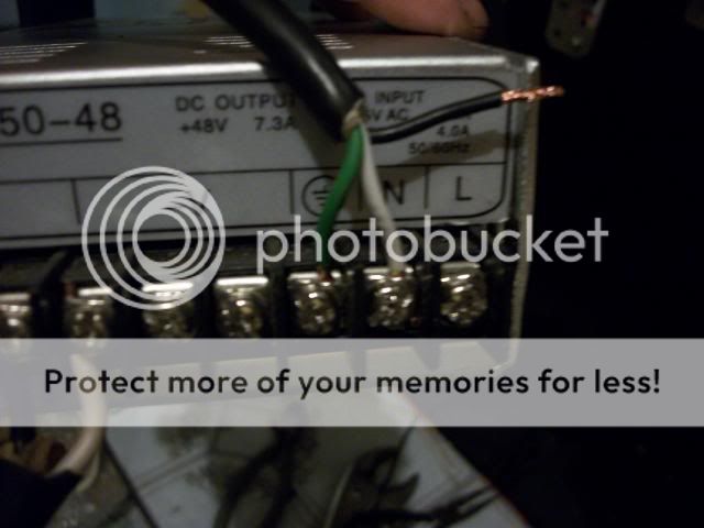

  13. #73
    Mar 2008
    3655

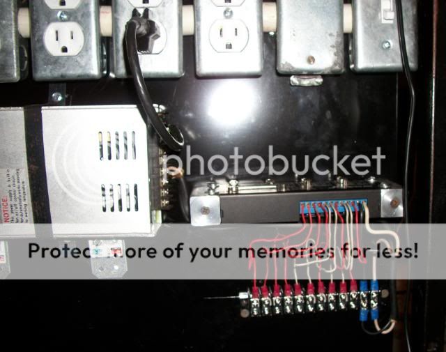

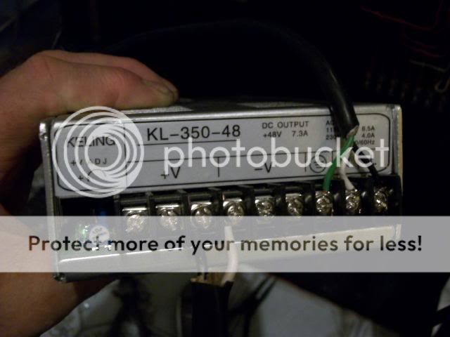

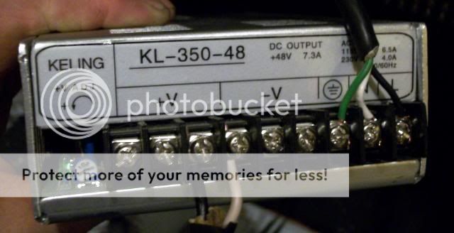

    After you have wired the G540, check all connections with an Ohmeter.
    Now, let's wire up the Power Supply:
    Short AC line cord was cut from back of a discarded clothes dryer. Wiring to TS is type NM 14 gauge house wire. Final PSU connection to terminal strip is Quick Disconnect with slide terminals.
    CR.

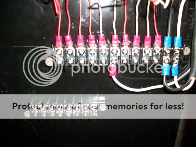

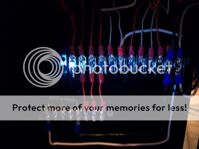

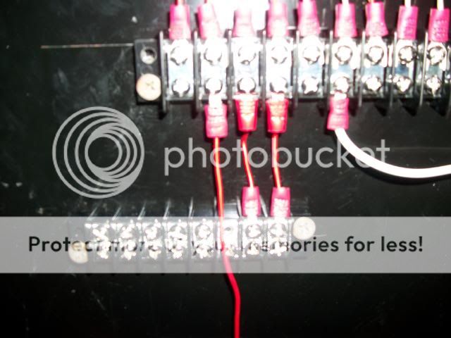

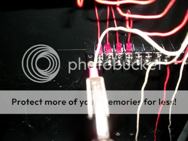

    Let's add an auxillery terminal strip. This strip will house the wires going to the apron area, and will be a platform for the 24V Voltage divider:
    These wirings will be semi-permanent. No need for slide terminals, so it will use terminals like this:
    Start of wiring it up:
    CR.

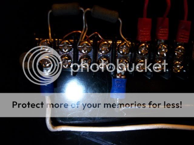

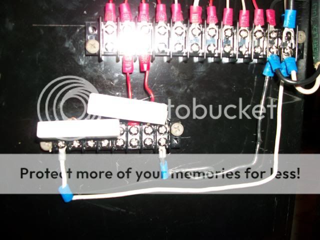

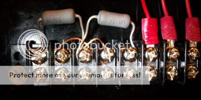

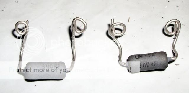

    Let's build a Voltage divider. Three 24V center terminals are joined together:
    Eyes are bent onto the 5 Watt resistors:
    Resistors mounted to terminal strip:
    Wired up with 48V:
    Now 48V is cut in half and a steady +24V is available at center terminals:
    This will power the 30V-max Hall Effect sensors and the 24V motor-control relay. There will be a constant 80mA drain on the 7.3A PSU, but There's plenty of excess Amps still available.
    CR.

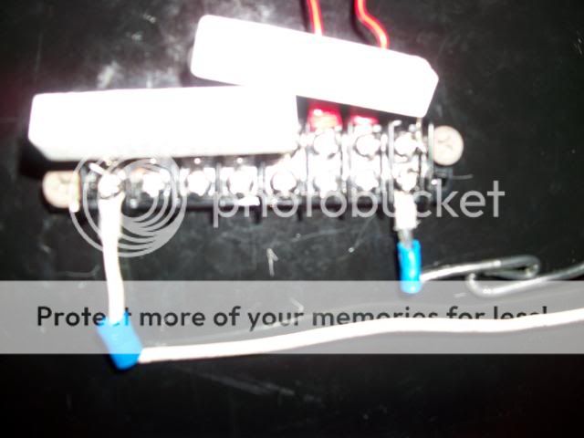

  19. #79
    Mar 2008
    3655

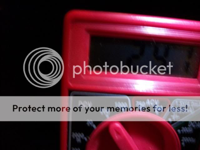

    Again, check all connections for continuity.
    I have misunderestimated the Wattage needed for the Voltage divider resistors. During testing, the resistors reach a temperature of 85 Centigrade or 185 Fahrenheit. This is actually workable as the T strip is good up to 120C, But I don't really want that much heat. I will replace the 5 Watt resistors with 10W. That should halve the operating temp.
    CR.

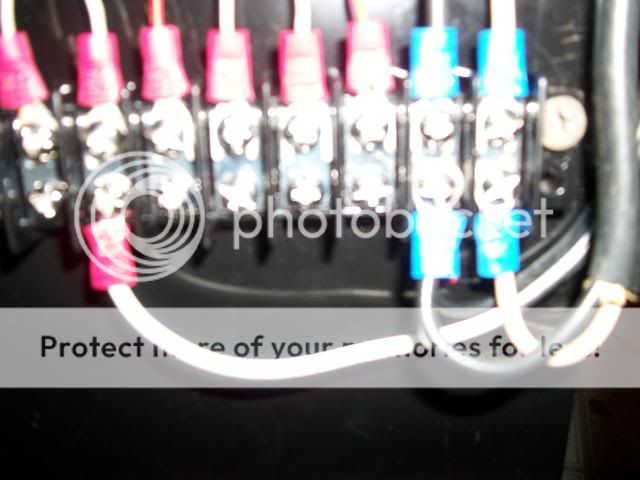

  20. #80
    Mar 2008
    3655
    The ten Watt resistors are much bigger. (Should have stayed with wire-wound) Had to change wiring layout for them. Removed an unused input wire and added a ground.
    There are now three 24V terminals and 2 Negative terminals:
    The new resistors DO run somewhat cooler, and temp is down to 150F. The 5 Watt leads were untouchably hot, but the 10W LEADS are only warm to the touch. This is acceptable and will have to serve.
    CR.
