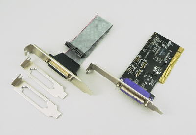

    I got it home and noticed it was lacking a printer port. Oops. Well not a problem, right? I'll head over to Microcenter and pick one up. Not necessarily the case. If you find yourself in this situation, save yourself the headache I went through and buy a Rosewill RC-304 2 port PCI card. Even though other cards list EPP mode, your computer will automatically select ECP mode. Since the add on card is not part of your motherboard, you cannot control this. This card works and is made to work with the G540! My charge pump is on and everything works flawlessly so far.

    Fyi, I found pins 1 and 17 on the Rosewill RC304 can't source enough current to drive the G540 reliably. They only source 1mA on mine, compared to 8.2mA on the other pins. The G540 requires 5mA, I believe. I made up a custom cable to use pins from both ports on the RC304 to drive all the inputs on the G540. This was causing me a lot of intermittent problems that I had a hard time tracking down until I broke out the o'scope and took a look at what was going on.
    I'll have to look into the low current issue on the Rosewill card. Like I said “works flawlessly so far” (there is always something) Was the one you got from PMDX? Apparently they customize the board for the G540. I know you can buy the standard Rosewill card for like $15 at newegg... Unfortunately I don't have an oscilloscope, what issues should I look out for?
    I bought mine from Newegg. I've got two of them now - they're great. I initially had problems with the printer port on a motherboard. It worked most of the time, but every once in a while (sometimes 6 months apart) the z axis would lose steps, sometimes catastrophically for a part. But then I wouldn't be able to duplicate it. Turned out it was due to low current capability, so the voltages going to the G540 were not in spec. I managed to reproduce it finally by running the axis very, very slowly. Then I broke out the scope - what I should have done to start with.
    On the Rosewill card, which I bought to fix the above issue, I initially found that all the motion worked great. I measured the voltage drop from one of the card's pins to see how much current it could source, and it looked fine. Then I tried whatever is hooked to either pin 1 or 17 - I think it's one of the relay control lines which I had turning on my spindle. It didn't work right. That led me to check more of the pins for current capacity. I forget if I checked them all, but I noted that 1 and 17 were really low, so I made a cable using db25 connectors from Radio Shack to use the 'good' pins from both ports on the Rosewill card. Problem solved.
    If the card's been modified, maybe that issue is fixed. You could check it by connecting an appropriate resistor from the pin you're testing to one of the ground pins and measuring the voltage drop across it with a DC voltmeter. Size the resistor to provide >5mA of current flow at ~5V, so for example, a 630 ohm 1/8 watt (or higher power) resistor would work (7.9mA at 5V, 6.3mA at 4V). You'll also have to use Mach to set the pin high (to 5V). If the voltage drop goes way down and thus current capability is low (less than 5mA), I would not use that pin with the G540 to avoid problems.
