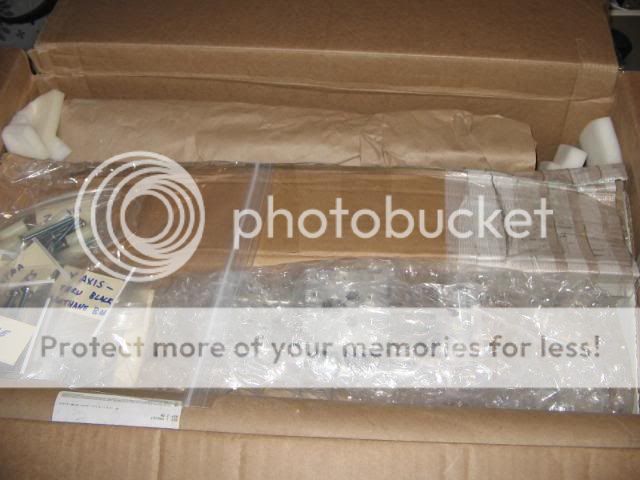

    Anyways he shipped it this past Saturday and I recieved it on Monday. IT was very well packed and recieved with no damage.

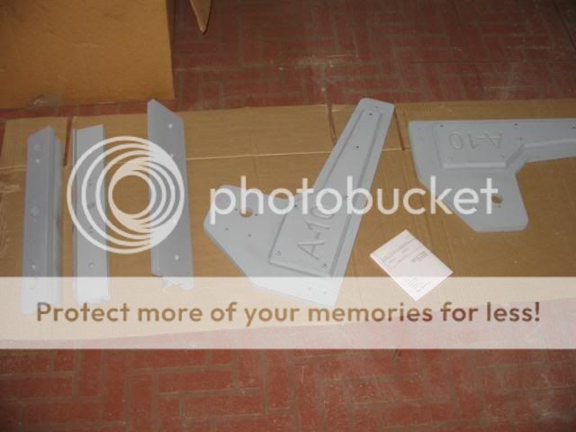

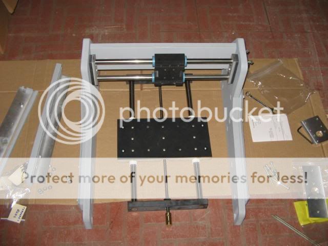

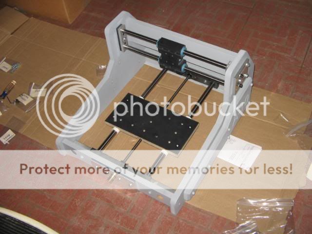

    Now I will let you know I have skipped some pics as I was excited to get it unpacked and decided to dry fit. note that not everything is not in the exact way it will be mounted( the front panel being one)
    Everything there is just sitting. No screws put in. So far nice build on it. One thing i will say, is the Z-axis assembly is silky smooth, just moving it by hand. Very nice work on it.

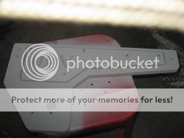

    So skip a few more steps and I have started sealing the mdf parts. Using the recommended Zinsser(sp) spray shellac. And also have started with the first coat of primer. I will say one of the main reasons I am painting it, is just to seal the MDF.

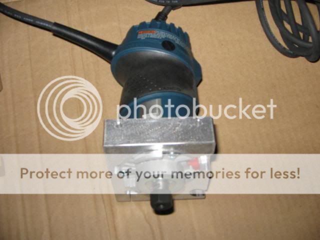

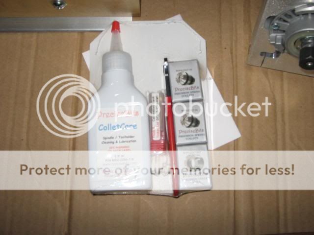

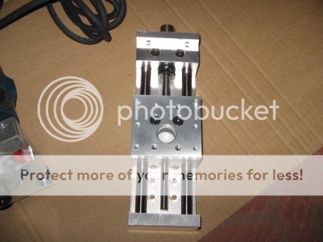

    And recieved some more goodies today. Over the weekend I picked up a Bosch Colt for the spindle.
    And my mount from K-2 arrived today. Gotta say nice work on it from them. Fit like a glove.
    Also ordered the precision grade collets from Think and Tinker.

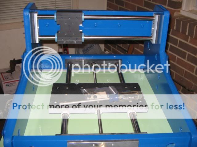

    Well over the weekend here I have managed to get a few things done.
    Got all the parts in primer..
    Did a little test fitting again..

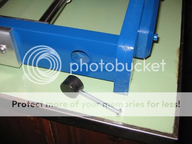

    Then it was on to paint. The brand I prefer is Tractor Supply brand tractor and implement paint. It is some tough stuff when dry( and it takes a little longer), but it has held up beautifully on other machinery I have used it on.
    I decided to go with Ford blue on this one.
    Will be doing the "A-10" in white. I have to get some better white paint so I can finish that.
    Here is the cleaned off rolling table I will be using for now. Good thing I had kept it, as I am now recycling it.

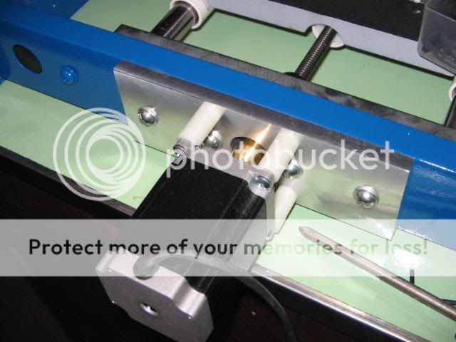

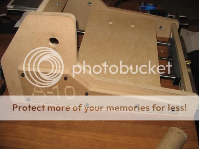

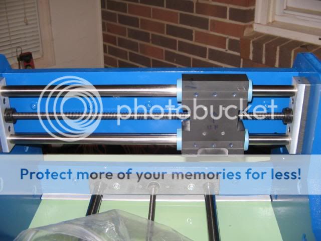

    So I started the assembly. Started by doing the table assembly first. It went smoothly as john had labeled all the parts to where they went.
    Then I assembled the gantry to the table assembly. 1 person can do this by themsleves all long as they take their time. What I did was to thread the bolts thru lightly snugging them on one side, then getting everything else lined up on the other. After that it was on to snugging up the machine.
    The gantry was pretty easy, as you only tightened enough until you felt a little drag on the bearing block and then back off a little bit. It glides smoothly along the rails. A very nice fit.
    Then I tightened the threaded rod torsion bars. Making sure to keep it still rolling smoothly. As I went along I checked for squarness with my precision square to make sure nothing was out.
    Then I threaded the acme rod thru, adding the plastic spacer and collar on in the right places at the right time.
    Then I tighted the front uprights in. Nice little idea of using a round with the threaded hole for this. It does in theory help with any little mis-alignment of holes.

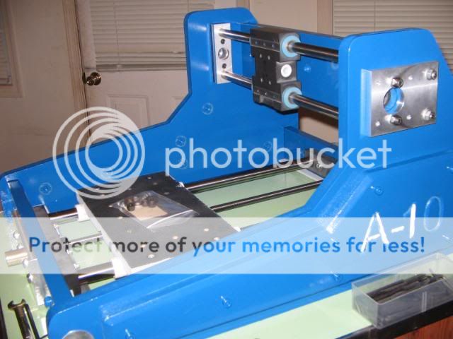

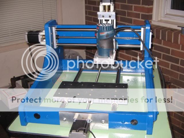

    And we have a basic machine now..
    Now for mounting the stepper motors.
    noticed I only I have the one picture of it. Will have to get more.
    And I also got the z-axis assembly mounted, along with my K-2 mount and Bosch Colt.
    That is as far as I am right now. Do have the steppers wired up to the G540, but I am having computer issues that I need to figure out, before I can go any further.

    Here is a picture of the machine as it sits right now. Has all the stepper motors on it, just waiting to come to life. As soon as I get the computer issues fixed.
    And then I also need to figure out how I want to route the wires. But that will come later.
