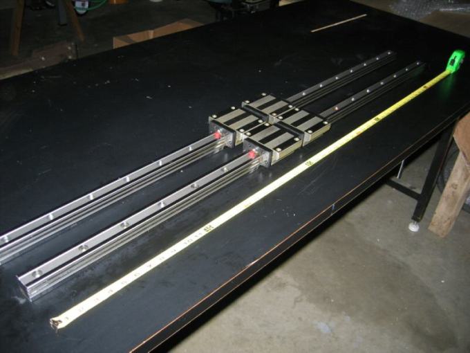

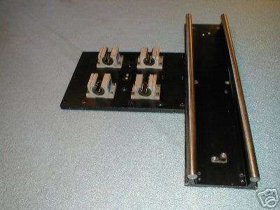

    Some photos of parts and materials collection process.
    This will be the Yaxis Gantry with modifications for end support
    These will be the x axis glide for the gantry.
    This, with modifications will serve as the Z axis

    Thats looking to be a nice collection of parts.
    Since you are only doing a 4 x4 table I am wondering if you should use belts.
    I only suggested belts so as to make it cheap. But you could use lead screws for that size.
    I guess all have their pros and cons. With screws you wont need as much down gearing as with belts.
    I think belts are only an alternative for long axis where you want to keep the cost down.
    Being outside the square !!!
