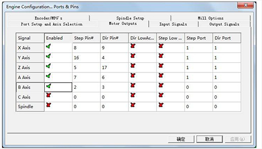

    Anyways, I'm having an issue with my 3040, it seems to be losing/gaining steps. I've tried calibrating steps with mach3, but the problem still persists, so I'd like to try changing the micro stepping, and/or motor current.

    Here is what are in the documents, but I'm really confused to what it all means, mach3 is setup from the second image, but I can't see any correlation between the 2.
    I'm guessing these pins are on the MCU? Cause the parallel port pinout couldn't work with these, as the Y axis is 16, and thats the reset pin on the parallel port.
