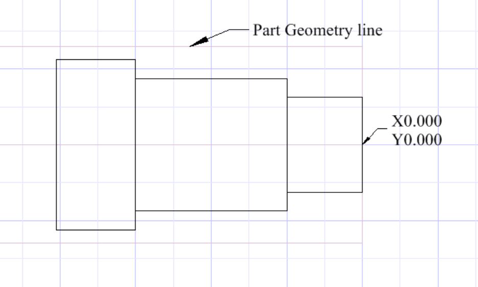

    I’ve used TurboCAD on the mill for a few years at home on V17 and have recently started using it on a ’91 Hitachi lathe my work acquired for cheap (free, our other store couldn’t figure out how to run it). My work then bought the latest V18 of TurboCAD/CAM to use for the Lathe (Which put me under a little stress that I had to figure it out now)
    First of all let me say that the CAM portion of TurboCAD leaves a little to be desired, and I really don’t think that the CAM portion of TurboCAD/CAM has been updated since they first introduced it on V12, but I think for the money this might be the only way to go if you want a single program to do everything. (I’m sure I’ll get beat up for that remark, but I’ve tried some of the other programs recommended on these forums and haven’t yet found one that I would consider overall better)

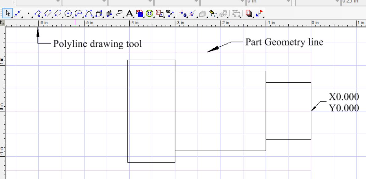

    Anyway, as far as cutting for a lathe goes I noticed that you have to use one of the 2 setup machines (in the CAM setup Wizard; either the “Fanuc-Lathe” or the “Tormach-Lathe”) and modify them for your machine; if you try to save to a new machine name it won’t do some functions like threading for some reason. Next as you’re going through the setup wizard when you get to the “Part Geometry” the “Length” and “diameter” has to be the same size as the shaft you’re starting with.
    Then when you draw your shaft and place it to be turned you have to put X0.000 and Z0.000 on the screen so that X is on the centerline of your shaft, and Y is also on 0.000. (You’re going to notice that X and Y in on the screen is backwards from the Lathe X and Z, “Y” on the screen is the “X” axis on the Lathe and the “X” axis on the screen is the “Z” axis on the lathe)
    After you put your shaft on the screen, what I do is draw a “cutting line” with the polyline tool and the most important part is that the cutting line needs to intersect the part geometry line. (To draw simple shafts I just make them out of separate blocks, and then put the radiuses in after I draw the cutting line)
    I’m going to try to post some screen captures to try to show the process that I use, this may not be the “right” way to do it but it works for me.

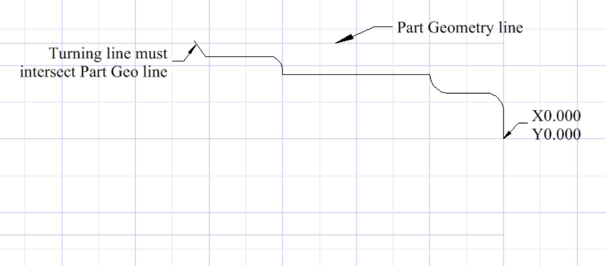

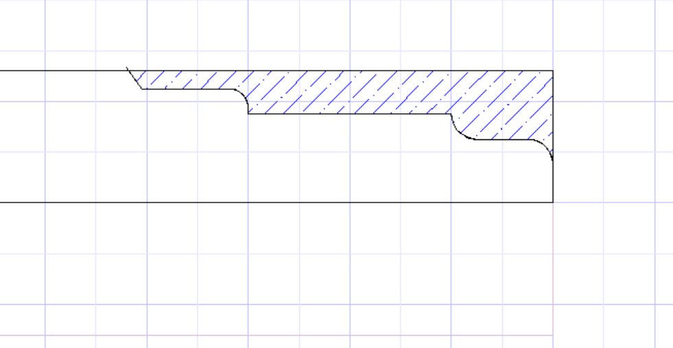

    If you've noticed this polyline doesn't look the same as the shaft in the previous pic I put the radiuses in after I draw the polyline (I've hidden the original "shaft" after I traced it with the Polyline)

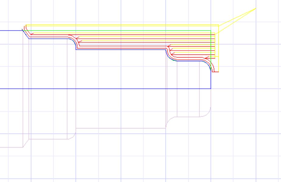

    Then you use the turning tool and click on the part first, and then the hashed area you want to remove. (Note that if you can't get it to do anything then your "turning line" may not fully intersect your "part Geometry" line)
    After that you hit the Finish button and it makes your cut.
    Hope this helps, this is just the way I do it and may not necessarily be the way the "experts" do it

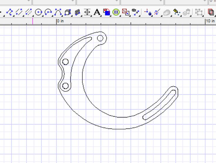

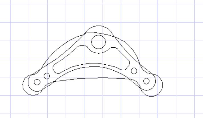

    You can do some pretty complex one line shapes with the polyline, and it can draw arcs, I found out while doing my CNC milling that it was always best to make a single polyline around all of my cuts to avoid errors when trying to machine the parts. I'm not sure about what the lines you were talking about, but here's some .jpgs of more complex shapes with milling parts
    First was an alternator bracket for my street rod, the OD, the spacer and the slot were all made with 3 single polylines

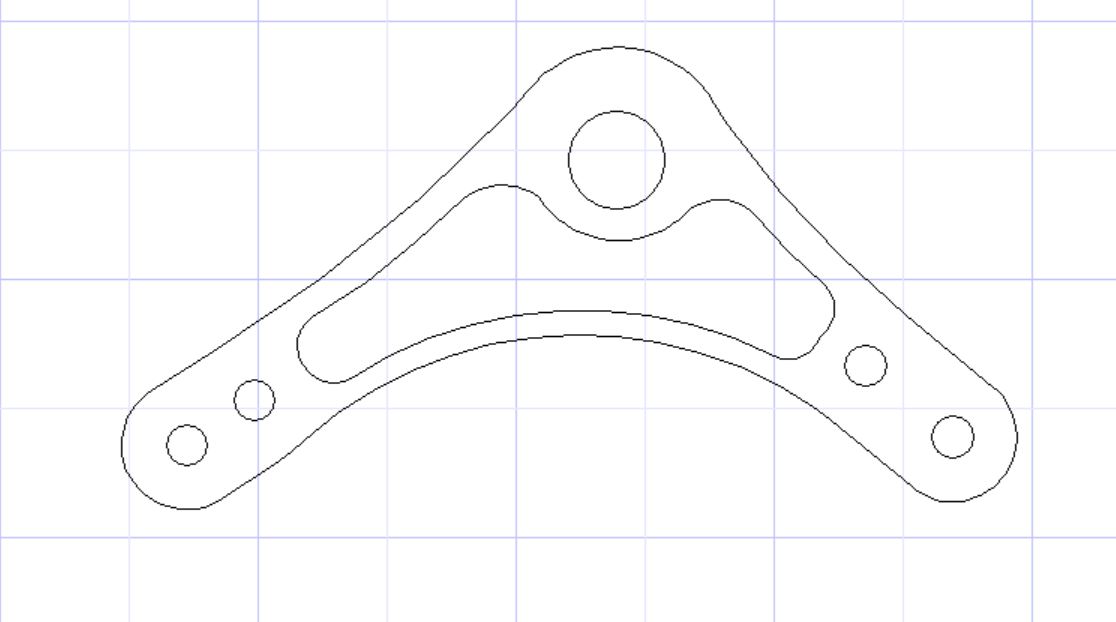

    I’ll show on a linkage arm that I made and how I trace it with the polyline, first is the linkage arm drawing:

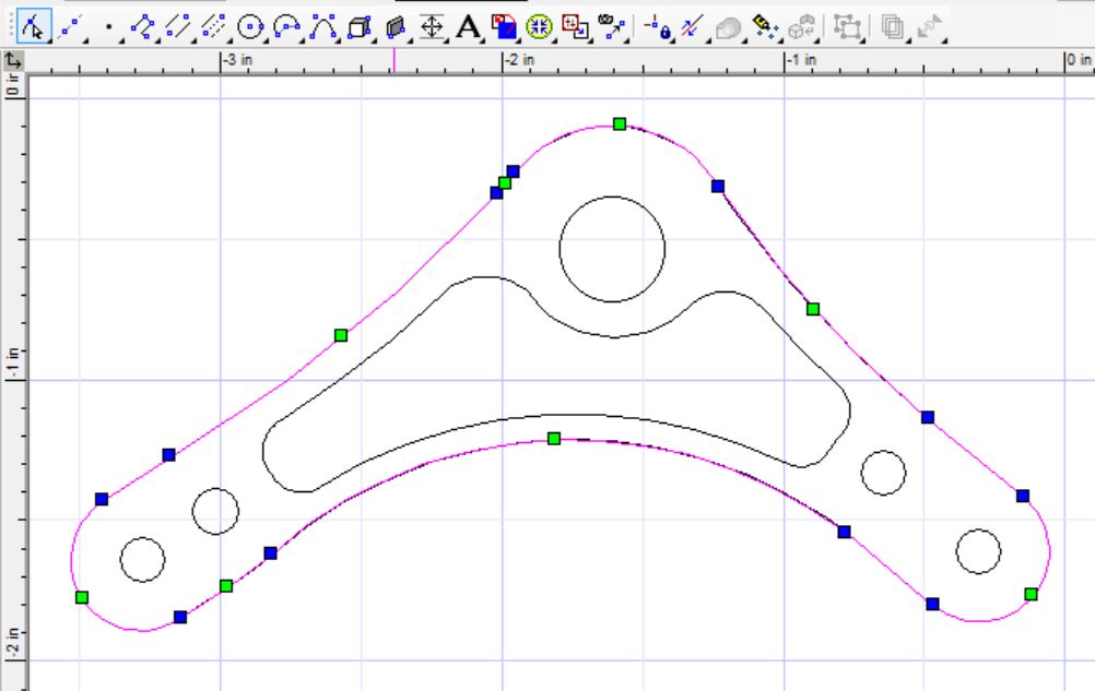

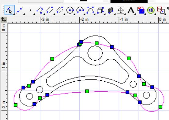

    Next I select the polyline tool and usually right click and use the “snap to->vertex” mode to snap to the ends of each circle. After you’ve snapped on the vertex of the first circle right click to open the pull down menu and go down and click the “arc segment”, then “snap to->vertex” of the end of the circle. You’ll notice on the pic below that the polyline is going all over the place (and many times it even looks a lot more confusing than this) but keep going around the cutting edge not worrying about where the arcs are going. (You’ll usually end up having to select between "arc segment" and "line segment" many times to complete your cutting line)
    Next use the Node edit tool (highlighted in the top left in blue in next pic) and select this wavy polyline that you just made and then grab the arc centers (green blocks) and use the “snap to->nearest on graphic” to pull the arc centers into place, (you may have to adjust the blue block positions also sometimes) resulting in the end cutting line being a single polyline (sometimes you may accidentally put an arc where a straight line should be and usually you can right click->”delete node” to make a straight line out of it, sometimes it won’t let you delete and you have to start the polyline over, but once you get a hang of the polyline tool it’s very quick to make this cutting line.
    Ending up with your single polyline cutting line, I don't think there's any type of a complex line that can't be traced like this, but I could be wrong. Like I said earlier these pics were from my mill projects, but the lathe stuff seems to be very similar with the main difference is just working with half the part on its side instead of the whole part.

    hmm that looks interesting. how does the node edit affect the accuracy of the dimensions? most of the stuff I machine is tied up to +-0.001". Manual editing does not sound like a good idea to maintain accuracy?
    Feb 2007
    9
    As long as you make sure that all your vertexes are snapped to the vertexes on your original part I haven't seen any variation at all (only do it by snapping to the original vertexes), you can roll the TurboCAD screen in with the wheel on your mouse and see instantly if your new cutting line varies any at all from the original line. (when you roll the TurboCAD screen in it will show resolution down to about 1/2 of a tenth of a thousanths or something like that, and if your line is off at all it will show 2 lines)
    I really wouldn't call it manual editing because if done right and snaps are used for everything you haven't changed any dimensions, only traced the dimensions already there.
    If you do lines with multiple arcs be very careful to hit the beginning and end of every circle.
