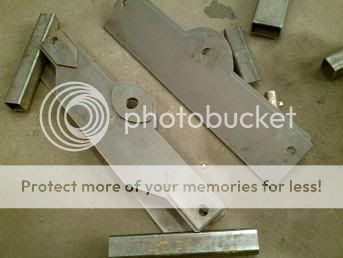

    well i see now why a water table isn't a bad way to go. the smoke and the warping of the metal. even 1/4 thick steel warps a little. so why is it that some water tables have the metal all the way under and some have it just sit on the top, not really in the water. im going to build a water table as soon as i get a chance for this table. i just dont know witch way to do it. submersible or not..?

    ya, its a minor warp but it still warped wright down the middle. i cut out a 45" by 24" football field out of 1/4 thick plate to make a table for a Buddy.
    i dont have allot of things cut yet. i just got the table going. the few parts i have cut is those control arms about 20 sets, and some towing attachments for a company here in town. we are building the back section (wheel lift). mostly for repo style trucks
    the table wont cut stainless or aluminum very good. not even the thin stuff. we still have to out source those pieces.
    the upper control arms are just one of the things we build for are customers. they like the oem look, and style of that arm. we also do tubular suspension for almost any make and model in the late 80's and older. i have a 6,000sqf shop were we work on custom projects, usually just a few at a time. the other parts we build is earthquake safety brackets to mount down top heavy furniture,computers,fridge,desk etc etc.
