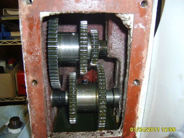

    I just bought a 1993, 17-20XMTC with CNC attached. My lathe spindle "snaps" or maybe "knocks" when running. I thought it might be a bad bearing so I disassembled, cleaned and inspected both bearings but they look to have normal wear. Called Shoptask and JT suggested it might be the gear broke in the key-way area next to the front bearing. Removed and inspected the gear and it looks fine. Only other moving parts, is the intermediate shaft with the hi/lo gears just below the spindle. The hi/lo selector lever, lower gear set, is in the "neutral" position so it's not moving and would not be able to make the noise. The lube is a "heavy" axle lube and not a light 10W machine oil as manual says. Jt says they use transmission fluid for serviceing. Has anyone ever had the same symptoms with theirs or have any ideas for me to check? Thanks

    Does the noise go away or change when you engage the Hi-Lo shifter? On the shift lever there is a roller that moves the lower shaft back and forth- this could be worn and knocking as it turns-
    Also check the end play on the upper gear. This gear is adjustable so it can be lined up with the gear on the spindle. Once aligned, the shaft is fixed by that allen bolt and cone shaped bushing in the front. At the rear is a big allen bolt that sets the thrust bushing in place so the gear can't move back and forth. If that bushing is not set, the gear can go back and forth and cause a knocking sound.

    Thanks once again for your suggestion. I tried adjusting the allen head screw, when it was running, and seemed to make no difference. I've got new bearings on order and thought I would try and remove the shaft and gears to inspect them. There are internal parts inside the shaft "but" I cant get the shaft out! I removed the allen head screw and the large slotted screw and used a drift pushing it backwards. Movement stops after about an inch and I didn't want to force anything. Have you removed this shaft before? Thanks

    Finally removed the intermediate shaft and gears with the help of JT at Shoptask. There was no problem found with them so I cleaned and reinstalled. Removed the bird cages of the bearings to see if there was any scaring on the inner races and found none. This is really getting ridiculous! Ordered the new bearings and I guess they will be here in a few days. Guess I'll remove the heavy axle lube and replace with the thinner Velocite lube in the gearbox.

    Thanks WormWood. The selector lever was one of my first thoughts, as there is play in it. But while running, it can be centered by hand to ensure it was not bouncing into the gears. On my older lathe there are no bronze bushings. The one black steel bushing, in the pic, is on the pulley side. The intermediate shaft is adjusted properly and is not the problem. My gears rotate on the shaft, while the shaft is tight in the housing, and has no slop. If you think of something else "just yank my chain!" LoL Thanks again for your inputs.

    Problem found!!! A big thanks to JT at Shoptask for his help! The problem was the gear on the spindle. When ever it was pressed onto the spindle, the key was too tall causing the gear to deform on a couple of the gears' teeth. After filing the key, making it a lower profile, and filing the deformed teeth it now runs nice and quiet.
