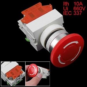

    Ordered two E Stop buttons from Amazon, one for the machine and one for the computer area.
    I updated the pricing on the rails as they priced the wrong parts.
    E Stop Buttons: $11.70 shipped.
    Total So Far: $1,600.34

    Got the PlasmaBot parts today and the E stop Buttons arrived.
