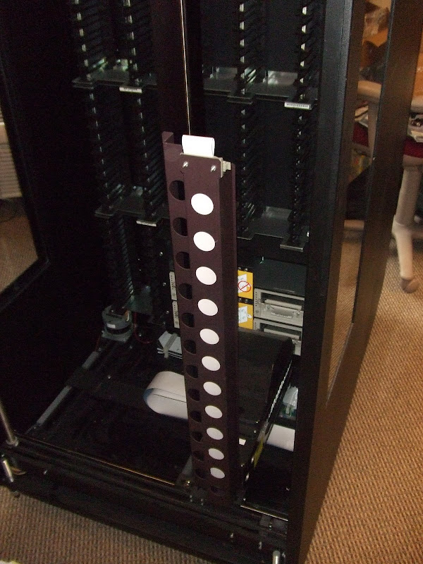

Well I've just discovered that I have many of the parts sitting in my server room from a robotic tape library that we dont use anymore. So my goal is to pillage the parts from that guy to build the table.
My starting machine is a Adic Scalar 1000.

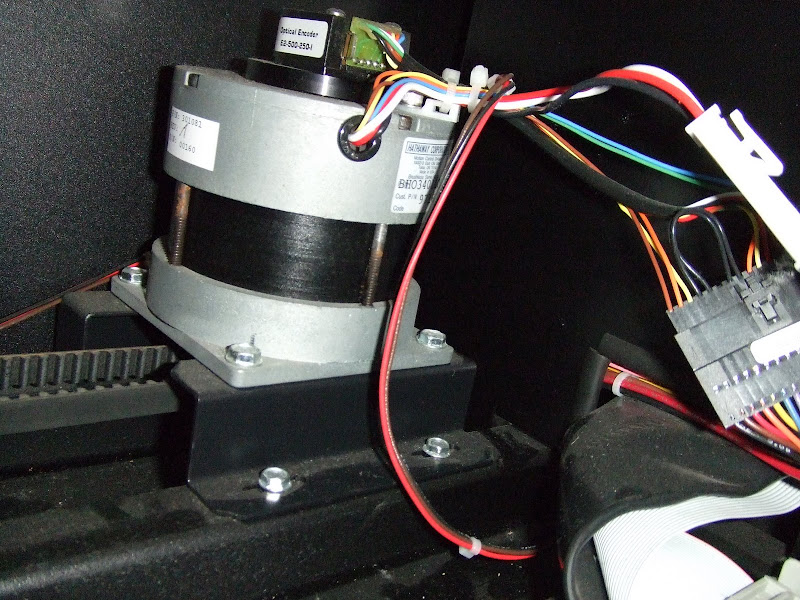

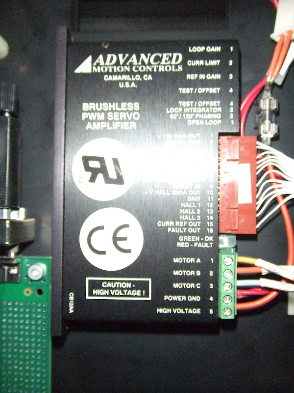

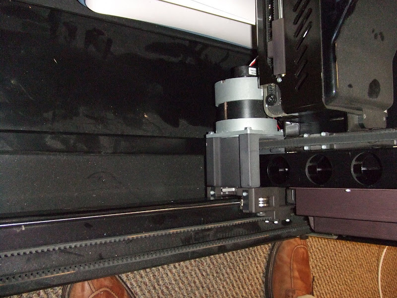

This machine has a 5'x2' XY gantry that I will modify to 5'x10'. It has 2 Advanced Motion Controllers and 2 Brushless servos with optical encoders. It's belt driven currently. (I would like to retain this if possible as it will make the build alot easier.)
Anyway here are some pics of the donor hardware.
The motors are Hathaway motors but I dont know what size they are.

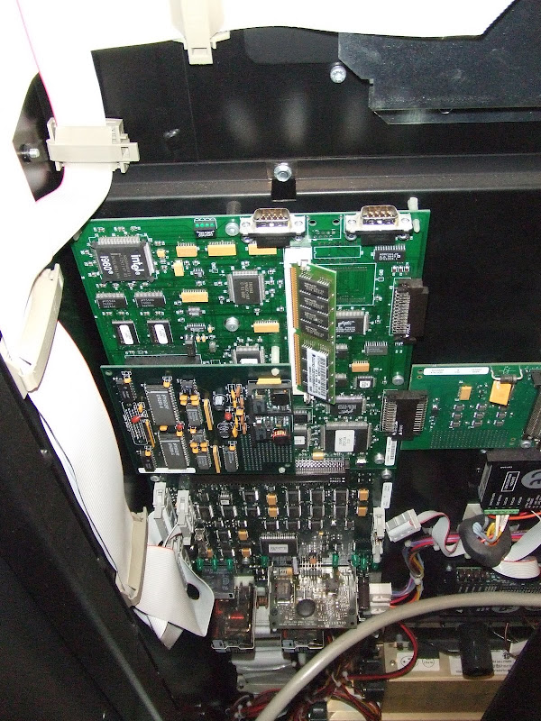

Mess of existing computer stuff to controll this thing. (not sure what all i can use for the table)
Anyway this seems like a good base to build from. I have 2 of these units. 1 is still in production and this one just sits there in the way.
Do you all have any recommendations? It also has power supplies etc so I should be good there.
Any idea on what size those motors are? They are about 3-4" in Dia.
Will the belt driven setup work ok for a start? I would like to start with what I have then modify it later if I need to.

this does look like it would be a good starting point for a cnc plasma. however, i just took the plunge into my first one as well.....only thing i would say is that without knowing what size motors you have, keep everything that will be moving as light as possible and don't expect a speed demon. anyway, good luck and i'll be keep up with it as you go along.

Another update. (no pics yet) I started taking the machine apart last night and I have 2 Celectica power supplies. 1 is 48v and 1 is 24v. Evidently Celectica bought Ascent Power and sells these units now. I haven't been successful in finding any documentation on the units because when i go to www.ascentpower.com I get an ITN website and the celestica website doesn't seem to informative just sales related.

Here are some pics of the Y I have to refabricate.
The gantry again
Anybody know where I might be able to find some slotted steel similar to the Y Axis rail I already have to replace?
