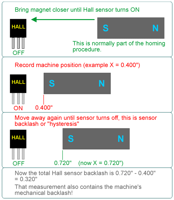

    Using the home switch to measure backlash?
    This works based on one concept; That the electronic home switch which we know has a reliable ON position detection, would also have a reliable OFF position.
    The Hall switch has hysteresis, this term means that once the magnet is close and the switch turns ON, the magnet must be moved away a bit before the switch turns OFF. This hysteresis is designed into the switch, and I assumed the turn OFF position was also thermally compensated etc like the turn ON position. Testing looks promising at this point.
    How does the switch do it?
    Well it is simplicity itself. The magnet is brought close until the swtch turns ON, this point is recorded.
    Then the magnet is moved away a couple mm until the switch turns OFF again. This position is recorded.
    The distance between the 2 positions I called the "sensor backlash" for lack of a better term. This distance includes BOTH the actual sensor hysteresis AND the machines mechanical backlash (as the machine has reversed direction).

    But how does that work?
    The "sensor backlash" is easy to measure automatically, with something like a homing routine or even as part of the normal homing routine.
    Because it contains two components;
    1. The electronic Hall switch/magnet hysteresis (should remain constant)
    2. The actual machine mechanical backlash (the remainder)
    if the first component can be quantified once, then every time the test is performed the remainder of the value must be the machine's mechanical backlash.

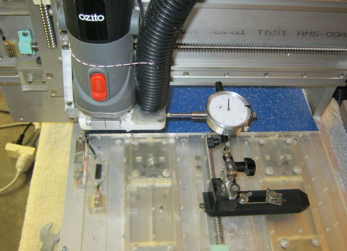

    The easiest way is using a dial gauge, a tool used on metalworking Lathes and is commonly available for $40 or so.
    Using the dial gauge to measure machine backlash
    I used the setup seen below, which is just a metal block screwed down to my CNC machine table, and the magnetic base hold the dial gauge in position.
    As the X axis moves right-left this moves the dial indicator. My dial gauge is just on 0.001" divisions (it's a cheap one), but it still shows pretty well to 0.0002" (ie; one fifth of a thou, maybe one tenth of a thou if I get fussy).
    Measuring backlash has issues...
    I knew from previous backlash testing on my machine there are some issues. The backlash should be tested in a "settled" position, as the vibration of your router and stepper motors will settle the position a certain amount.
    I did the settling by pushing the axis hard with my hand, then releasing it and tapping it VERY lightly with a plastic screwdriver handle a few times. Then pushing hard the other way, and after releasing and tapping again checking the dial gauge.
    Backlash on my machine at this point (machine is cool);
    X = 0.0025" = 0.06 mm
    Y = 0.0021" = 0.05 mm
    That made me fairly happy, the machine has plastic leadnuts and there seems to be no wear at all after many months of use (although intermittant use).
