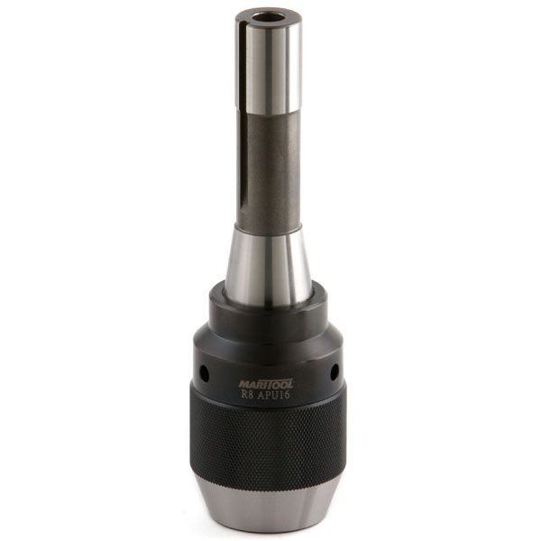

    Follow up question: Would it be possible to use this keyless chuck with an NM-200 mill? I figure if there isn't something stopping the spindle from turning it would be difficult to use a keyless chuck because when you attempt to loosen or tighten the chuck you'll end up just turning the whole spindle.
    R8 DRILL CHUCK TOOL HOLDER BRIDGEPORT MILL 16mm MariTool

    I've never seen that chuck in person, but if I understand the description on Mari's web page correctly you don't need a spindle brake (lock might be a better term) to use the chuck. The wrench included with the chuck is probably a pin spanner that is used to engage one of the round holes that can be seen in the chuck body above the knurled section. The wrench is probably used to keep the upper body of the chuck from rotating while you loosen or tighten the chuck jaws with the knurled part.

    Oh cool! I was thinking maybe I shouldn't be calling it a "keyless" chuck if the MariTool page didn't actually say it was... I was wondering what those holes were for.

    as mentioned, you dont need a spindle lock for that chuck. in any case, the nm200 doesn not have one. you would use a wrench at the top of the drawbar like youd do with most other tools (like an er chuck).

    I can't say for certain, but if the Maritool drill chuck is like the Glacern drill chuck the spindle does need to be locked somehow before changing drill bits. I'm 99% sure the spanner wrench holes are in the same piece as the knurling. They are there to allow you to use a spanner wrench to torque the jaws down with greater force than you would be able to using the knurling.

    You are 100% correct, and yes I have one. The holes are for increasing tightening torque.
