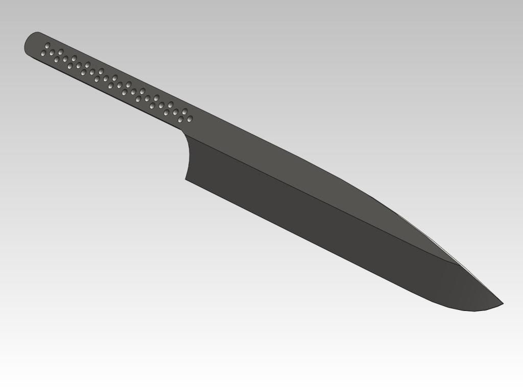

    Since I'm waiting for some materials to get in, I thought I'd spend my down time walking through modelling a part and then creating associated tool paths.
    The part is a chisel ground kitchen knife with a skeletonized handle. Chisel grind means it can be done in a single setup. Going with a skeletonized handle makes it pretty usable without making handle slabs.
    I am self-taught and inexperienced, so feel free to point out opportunities to improve the design and process.
    Here's a render of the part.
