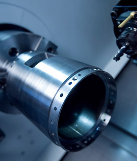

Here's a project we worked on awhile back... a 7" OD x 5.5" ID tube with ID chucking. Due to the length, we used some fairly long soft jaws.
If the walls are sufficiently thick, regular jaws should be fine. If they're thin, either lower the jaw pressure or use pie jaws.
