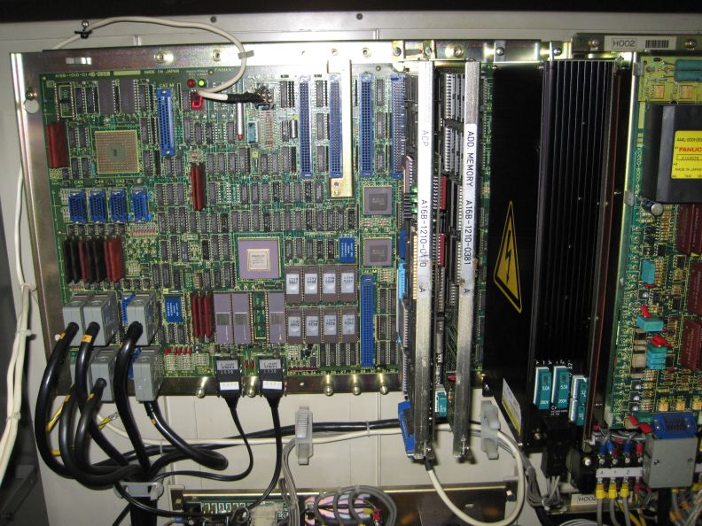

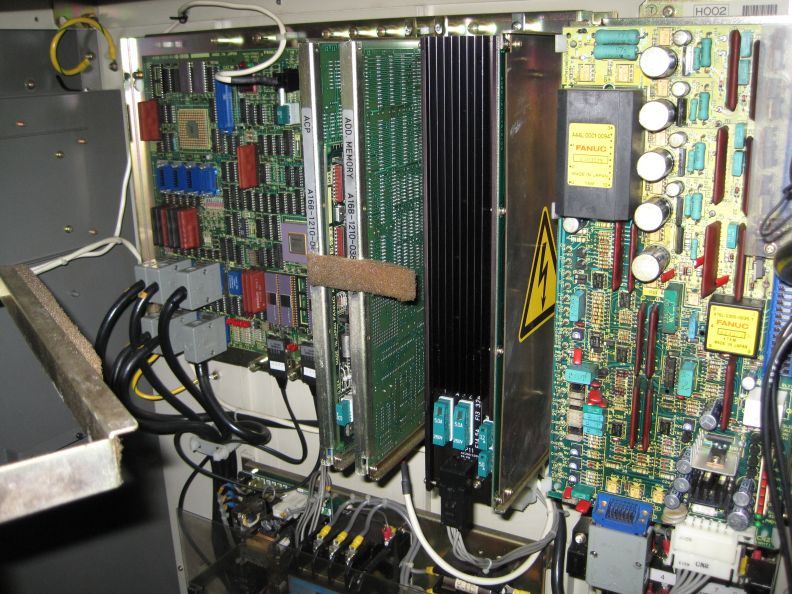

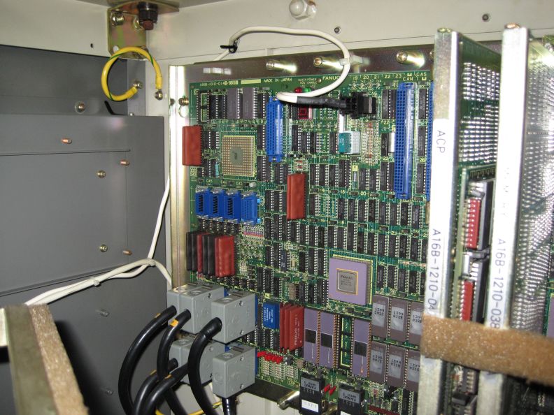

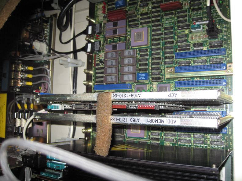

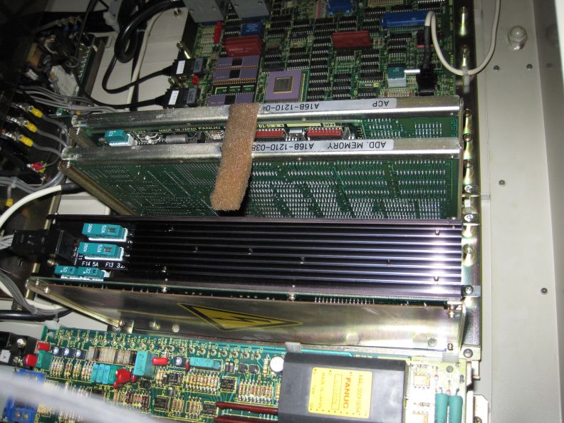

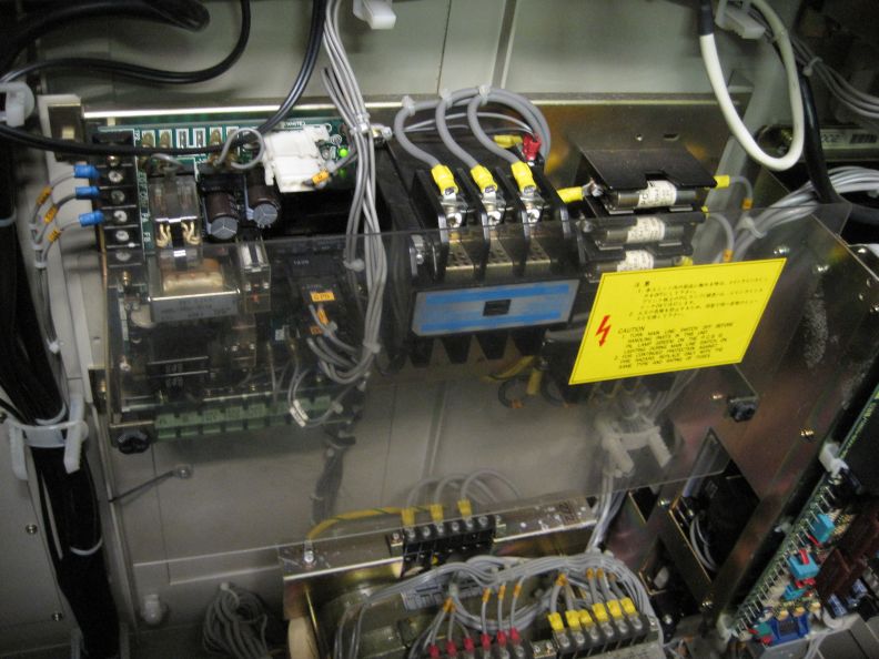

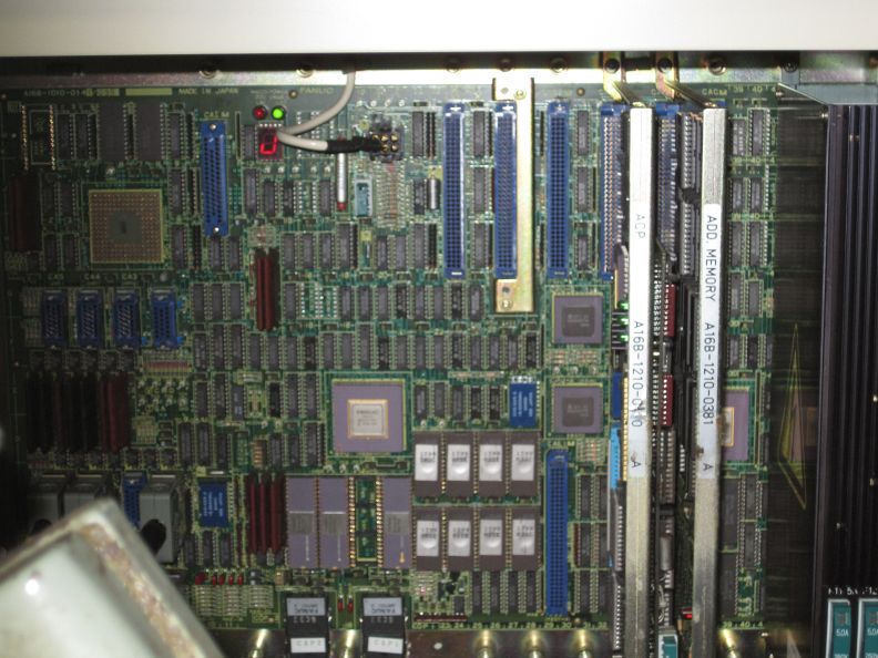

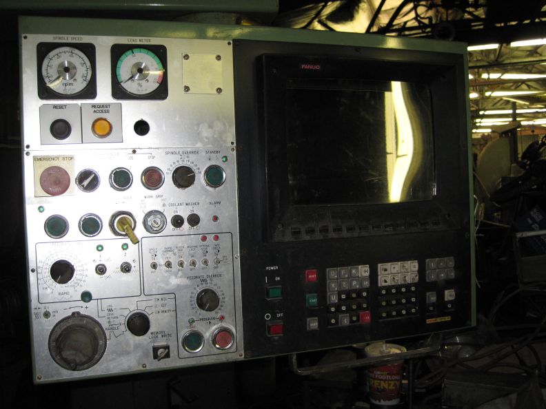

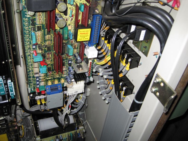

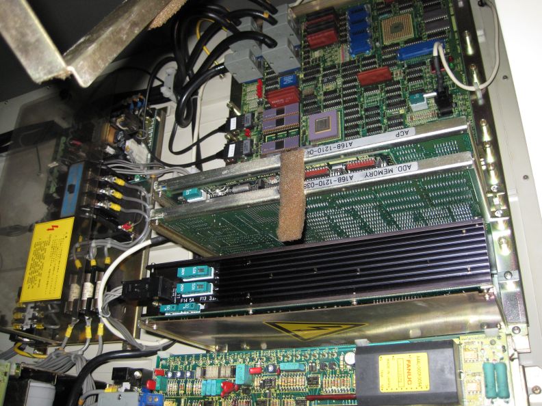

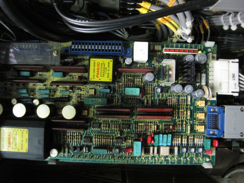

    Ok, I bought this HItachi-Seiki Lathe with a fanuc 10te-f controller. When I power it up, the screen says, imput search for a couple seconds then it comes back with no signal. I bought this machine NOT under power, so I didnt have a clue what the status was on it. Anyways, I started lookin in the two controll panels, in the circut boards to see if I can see where a board was missing. I took some photos, of the controller cabnet, and I think, there is a board missing. I beleive it is one that snaps into the existing circut board, next to the add memory ones? Can someone look and see if they see which board is missing, and what the part number might be so I can try to source one? THanks.
    Community Moderator Al_The_Man's Avatar
    Dec 2003
    19110
    According to my 10TF manual the first one would be an Option card, usually reader punch and possibly high speed skip.
    The second is additional axis + additional memory
    The third would be the conversational function.
    The second card would be the minimum, I believe?
    You could be missing the PMC cassette? do you have a slot marked CAS to the left?

    I don't recall exactly, but some Fanuc's that do not have the PMC (ladder) burnt into eprom, use a ROM cassette to read the ladder off into memory at boot-up.
    Is there no response at all on the screen or any other message of any kind.
    Actually I think I see the vacant CAS socket in your pic.

    When I power it up the CRT only says, "imput search" then after a couple seconds says "no signal"

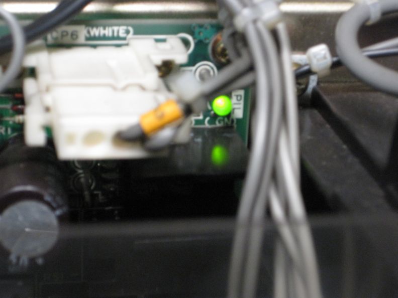

    I can see where there were screws in the holes where the cassete should of been.

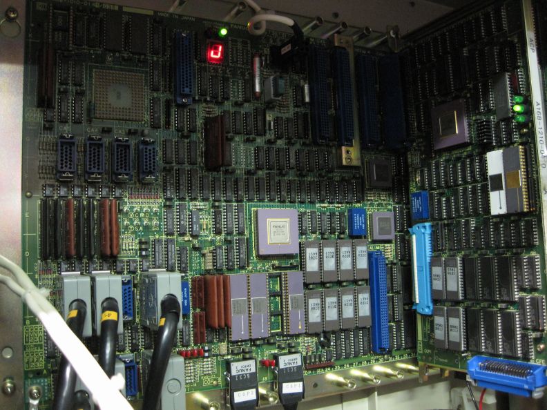

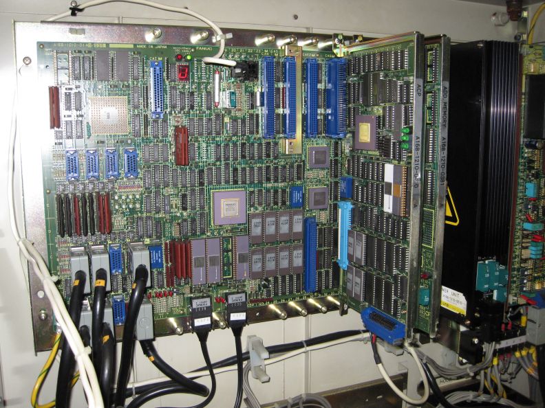

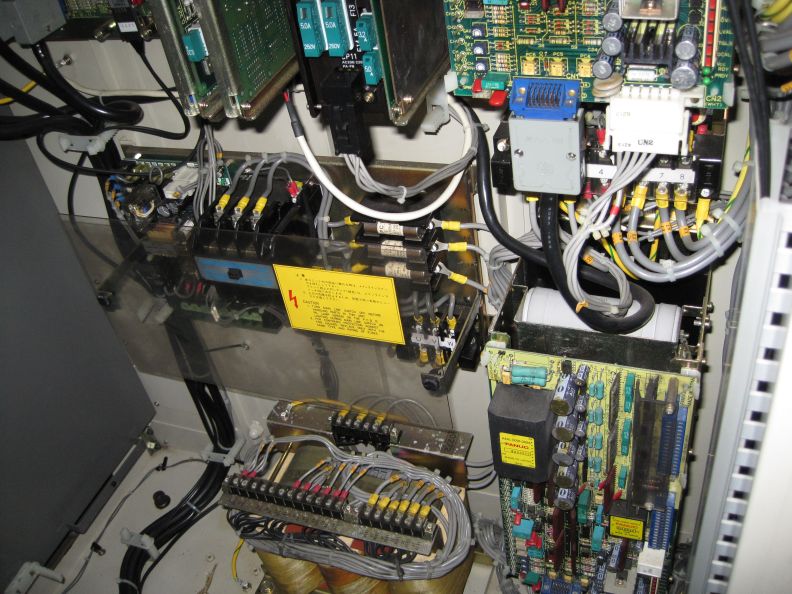

    Ok, here are some photos with the machine turned on:
    Dec 2003
    19110
    That appears to be a J on the 7 segment display,if so, J is PMC RAM is not mounted.
    I show the PMC RAM cassette as A20B-1000-0910 for the 4000 step PMC.
    Or A20B-1000-0920 for the 16000 step.
    I have got them cheap on ebay, but it has to have the OEM ladder loaded into it.
