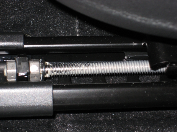

    As a VW tech by trade, and now slowly getting parts to build my first CNC mill because I don't have one (don't need one, but that isn't important), I've noticed 2 parts in VWs that could be used...
    The 2005.5 and newer VWs have that a power seats have these lead screws. I'm going to see if I can source one out of a junk yard for cheap, with luck I'll have some good news to post. This is not a separate part, it is part of the lower seat frame asm, which is costly.

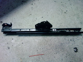

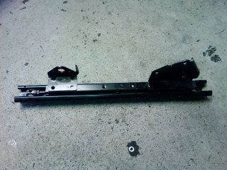

    Happen to be at the junk yard at the right time over the weekend, saw a 08 Passat with deployed side airbags being dropped off and it had power seats. With the side airbags deployed, the seats were worthless, so I was able to get the lower track assembly at no cost. So, lets see what the lead screw really looks like. Sorry about the bad photos, had to use a cell phone.

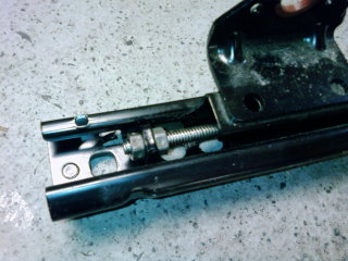

    Everything kind of bolts up together and such. Able to strip it down to separate left and right side guides.

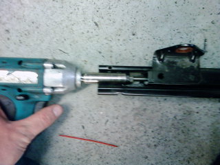

    There are a couple of jam nuts at one end.
    Remove the outer jam nut, 12mm socket.
    Now slide the upper section of the track forward.

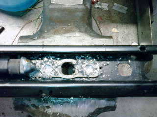

    The other end of the screw is welded to a bracket that is in turn riveted to the lower part of the seat track.

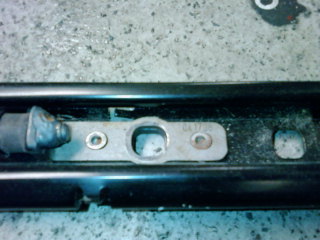

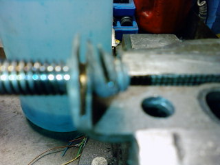

    There is a another steel plate under this section, clamped on that in the vice and drilled out the ends of the rivets. Then punched them out. This only took a few minutes.

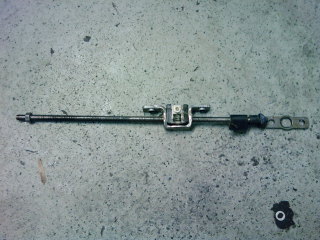

    Once the rivets are removed, pull the lead screw assembly out the rear. In the middle is something like a gear box, and the other jam nut on the end. They just unscrew without much issue.

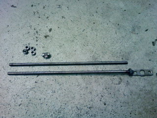

    The lead screw is welded the the L bracket at one end. I used a cutting wheel on a grinder and made a slot as to free the lead screw.

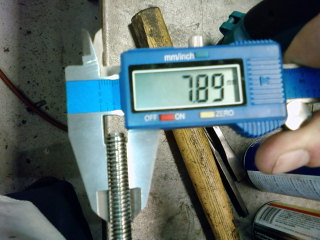

    That is that. A bare lead screw and one with other with the bracket still attached. The lead screw is about 12.25" long. You get 4 nice same nuts as well. They are dimpled so that they don't turn freely on the treads.

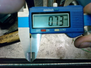

    The width of it, 7.89mm
    And I hope this is useful as well, the thread is .73mm wide.
