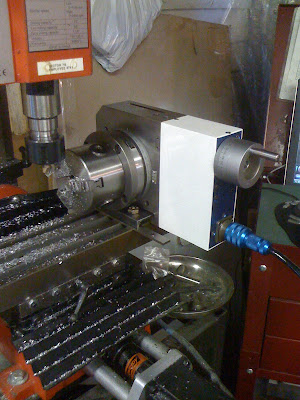

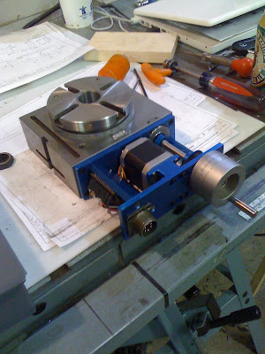

    Mongkol, thanks for the links.
    In the first link, ger21 says Mach3 will do tangential control only for G1 commands, but I think this has changed. I wrote a simple program to cut out a rectangle with rounded corners and it handled the G02 and G03 curves fine, although this was just a simulation since I don't have a tangential axis yet.
    The Comagrave is a pretty nice machine. I think I could design in an oscillating tool holder by adding another through shaft that is keyed inside the main shaft. This would add a fair bit of complexity, but could be done.
    Yes, to use tangential control, you install another motor driver as the 'A' axis. There's a button on the settings screen to put Mach3 into tangential control, and that's it. The 'A' will rotate according to the cutting path.
    As far as software goes, Sheetcam would work fine. Just use zero offset paths and away you go. I think the trick is to get the cutting tip exactly on the 'A' axis rotation.
    Overcutting isn't handled by Sheetcam as far as I know, so this would have to be drawn in as part of the .dxf.
    I'm pretty pumped about building this little machine. I just finished a CNC rotary table a few months ago, and this will be very similar as far as components and control.
    How many should I make? Is anyone interested in buying a completed unit or just the full set of plans?
