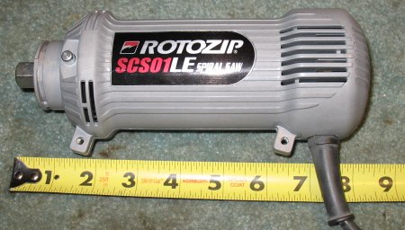

My first router table will use a free Roto-zip tool.
It's basically a much more powerful and larger version of a dremel tool.
My Z axis will have 4 inches of travel.
I am not sure how high off the table surface I should make the Z Axis tool holder.
If I had a 2 inch long drill bit in my rotozip, I would have to start with the Z axis lower so I can reach the workpiece.
If I had a 4 inch long drill bit in my rotozip, I would have to start with the Z axis higher.
Then there's the workpiece surface height to consider.
I guess I have to decide what the maximum height of a workpiece material will be?
It would be nice to be able to slide the RotoZip up or down and relock on the Z axis tool holder for different height tools.
My brain is spinning trying to figure out where a good place to fix my Z axis tool holder.
Any suggestions on what the real world operating conditions would be, typical tool lengths, etc.
How have other people set up their z axis tool holder heights above the table surface?
Thanks for any help.

I figured out a bunch of stuff today with some help from the guys over on the Cambam forum.
http://www.forum.cambam.org/index.php
Walt came up with a cool idea on how to make the Z axis tool mount, slide up and down.
Got a few web page of info on the build so far at this link.
http://www.el34world.com/Misc/Cnc/CNC0.htm
