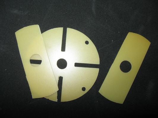

I have coupling like this for $15 each
Click image for larger version
