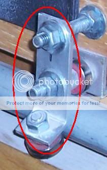

    Today I'm replacing these aluminum bearing brackets with steel. The aluminum here is a real weak point IMO. They just flexed rather than tightening against the rail. This allowed the gantry to be forced off the top of the rails over 1/16"! I'm sure that could have caused some ugly chatter in the Z axis...

    The 'flexing' of the bracket is intentional, and it took me a little bit to understand. Basically most pipe we use for diy machines comes from the big box stores, and are made to varying tolerances, even within the same piece! The slight flex in the alumin sort of compensates for it. Where the flex gets to be too much is when the angled bearing is not far enough below the rail. You could either add a washer next to the bearing to move it 'under' more, or adjust the lower nuts on the bracket mount to add more pressure to the rail. The key with the solsylva design is to add just enough tension to make the system tight, without making it bind or loosen due to any undulations on the pipe surface.
    If you take too deep a cut or plunge too dep by accident, or hit a clamp or such, you could potentially flex the bearings off the track, and I've done it a few times, but it's almost like a built-in safety feature that prevents your machine from self-destruction should a boo-boo occur...

    Oh that does make sense now that you mention it. The problem with my machine is the racks prevent the gantry from popping off, so the flexing doesn't help me in this regard.
    The bearings still hug the rails nicely with the steel brackets, and I was able to add spacers to better center-up some of the bearings on their path on the rail. Easy switch back to aluminum brackets if something goes wrong with them down the road.
