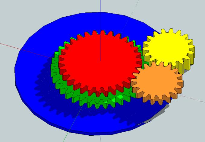

    Since you have access to a laser cutter, you may want to try the gear arrangement I'm working on(if you're looking for things to do). These are the parts that go inside the ring gear.
    The yellow gear meshes with the ring gear. The orange and yellow gears are mounted on the blue carrier. The ring gear is the output.
    Here's how it operates:
    1st gear: hold the blue carrier to keep it from turning. Turn the red gear. The ring gear will turn at less than half the speed.
    2nd gear: hold the green gear and turn the red gear. The ring gear will turn at a reduced speed, but not as slow as 1st gear.
    3rd gear(direct drive): Turn the red and green gears together. The ring gear will turn at the same speed.
    4th gear(overdrive): Hold the green gear and turn the blue carrier. The ring gear will turn 50% faster.
    Reverse: hold the blue carrier and turn the green gear. The ring gear will turn at a reduced speed in the opposite direction.
    Neutral: Don't turn anything
    I'll attach the red, green and blue parts to shafts to make them easier to handle.
    Micro
