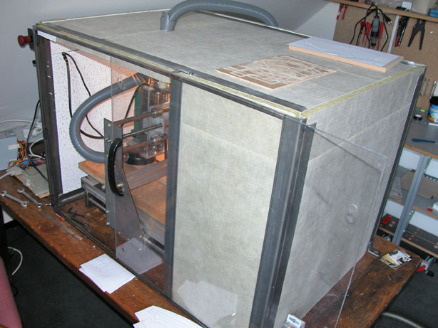

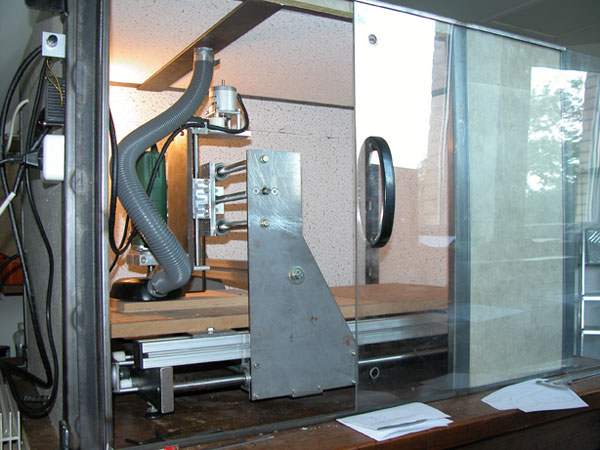

Because I took up a room in the house, I made cabin around the cnc machine with a dust suction.
I was getting bored sitting there holding the vacuum cleaner.

The router looks nice. I have a sugestion. have you thought about a flip of the Z-Axis to the other side of the gantry/Y-axis. With your sedign of the y-axis leadscrew being centered with the rails this would be a very easy unbolt and rebolt, then reverse your motors in software.
Joe
Old 07-03-2007, 01:16 AM
Join Date: Oct 2004
Location: The Netherlands
Posts: 23
EddyK is on a distinguished road
Joe, good idea.
I would gain indeed a few inches. So when I ever need more room to cnc, I can rebuild it. Should be fairly easy indeed.
