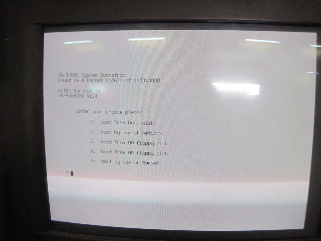

    Hi,
    I had problem, HDD broke down, successfully got recovery and new disc. Connected, but OS can not boot from disc, maybe because BIOS can not recognize. This is what I get. Can any body help me how to get access to BIOS?
    This search for boot device go on and on.

    Here is thing I found my self.
    So call BIOS is RMON (resident monitor) v. 1.7.1 (13)
    What confuse me is disc ID. On disc from machine what was recovered ID was 0 (jumpers), also for new disc stand same ID. Now in RMON settings I see:
    SCSI own ID 07 also factory default setting is 07.
    Any ideas?

    Machine is working, thanks for reading my post
    Disc ID plug 7 and everything works.
