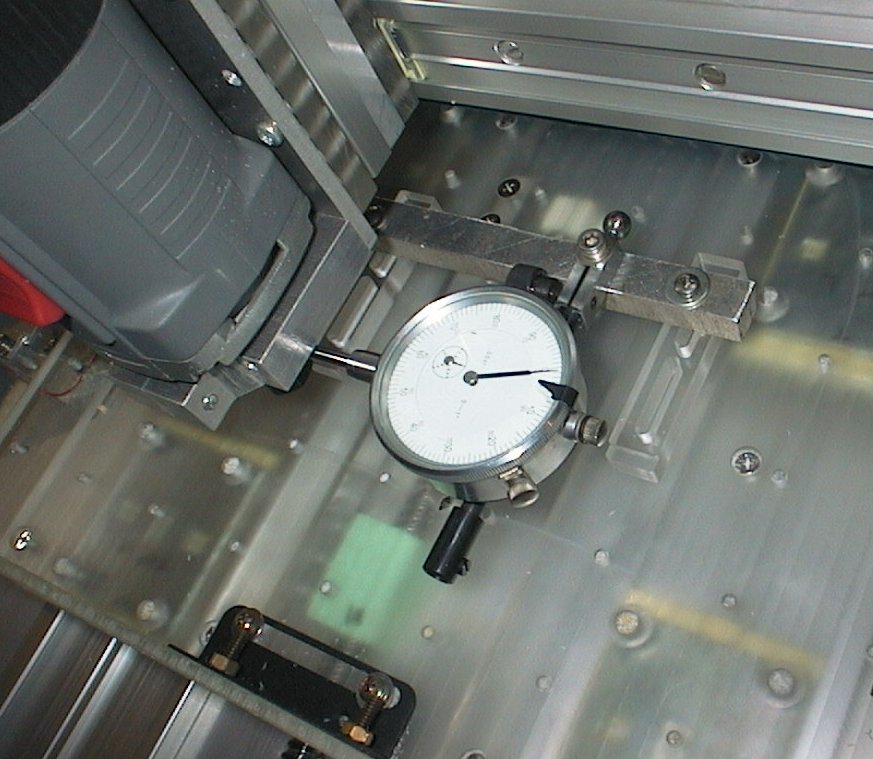

    Backlash Update.
    I mounted up a dial gauge and did some tests on the backlash of each axis;
    X axis;
    Test 1 = 0.0032"
    Test 2 = 0.0032"
    Y axis;
    Test 1 = 0.0027"
    Test 2 = 0.0027"
    Z axis;
    Test 1 = 0.0006"
    Test 2 = 0.0007"
    Test 3 = 0.0007"
    The Z axis backlash is much less as I have a tighten-down screw on that leadnut making that nut significantly tighter, and of course the weight of the Z axis assembly and router.
    Now what to do with the X and Y axis backlash? I can easily compensate in software but I'm not sure if this is the right thing to do. When the router is running I measure about 0.001" of vibration on the Z axis plate, and the X and Y backlash totally disappears, which explains why it cuts perfect circles with a cutting tool. The only time backlash is evident at all is with extremely fine cuts, like when doing fine engraving.
    I might post the question in another thread and let the backlash experts have a stab at it.
    (Large picture because forum image attachments seem to be broken today... )
