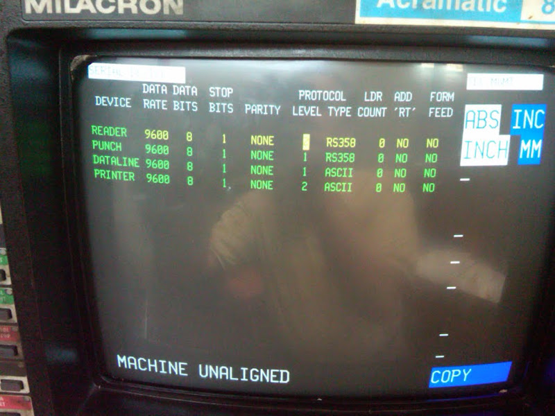

    I have a Acramatic 850 control that refuses to communicate via serial port that I have been called in to look at.
    Cable between PC and machine is tested and is good. Running a full handshake cable which we can get perfect communications on between a laptop and the desktop PC intended to communicate with this CNC.
    I ran continuity checks on the cable running inside the machine between the processor boards HD-15 connector and the external DB-25 connector in case it was shorted out or broken and this wire is fine.
    When I boot up the CNC an alphabet series spits out to the PC "ABCDEFGHIJKLMNOPQRSTUVWXYZ" in 9600-7-n-1 com.
    I am able to easily edit the COM settings in machine setup and I have tried using the default 9600-7-n-1 protocol level 1 and 2 (hardware or Xon-Xoff handshake)
    That's it though. No communications once the controller boots up.
    going into terminal emulation on the control and no characters come in.
    Trying to do a transfer to the Line and not a single ascii character comes through on the serial port of the PC. (I have a utility that shows every bit sent or received on the computer and lets me send any ASCII code)
    Tried sending a NULL (hex 00) when initiating a file transfer and no response until the controller times out.

    I know on mine it will only work with the machine set to 2400 8e1 and the pc set to 2400 7e1 , really makes no sense to me but I think I tried every different combo.

    If using 'ASCII' setting on the Device Parameter page, make sure the PC parameters match the A850 settings.
    If using rs-358:
    Set the 850 to 8 data, 1 stop bit, no parity
    Set the PC to 7, 1, even parity
    Protocols 1 and 2 refer to hardware or software flow control respectively - that also has to match the PC.
    If you want to check the serial port output, install a loopback plug on the AUX port, set the control to Level 2 protocol, go to the Terminal screen, and start typing characters. You should see double characters (the one transmitted and the one received).

    simple solution
    here is the simple solution
    change the MTBCOMM parameter no 110 to value - "37"
    make sure that you have % sign at the end of program in your PC
    in your computer and machine keep following parameters
    2400/7/E/2
    in your machine keep the level 1
    add RT - yes
    in your computer send setting:
    just software handshake, no hardware handshake
    in your computer receive setting
    software and hardware handshake
