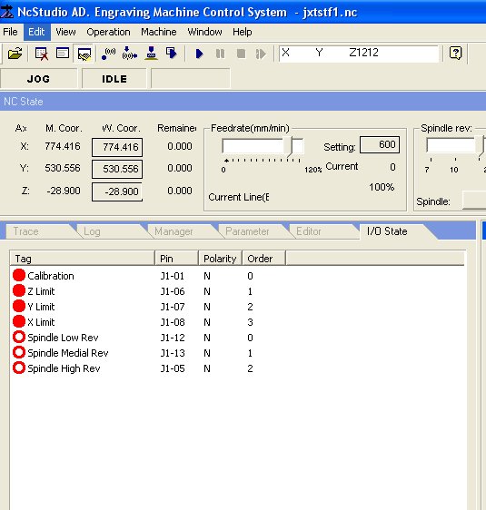

    I managed to hook up a piece of blank PCB as a touchprobe for zeroing the z axis to my NC-studio controlled router.
    After making sure that the machine was earthed correctly. The power socket earth wasn't connected at all so I grounded the chassis and the power supply and verified that there was no voltage between the PC earth and the chassis of the machine.
    Then I opened up the IO state tab in NC-studio:
    and verified that the calibration input changed state if a wire on pin 1 of the 15 pin cable was grounded - it did:
    Then I soldered a 1" square of blank PCB to a long wire connected to the NC studio breakout board in the machine and verified that the "calibration" input changed state if I touched the copper surface of the PCB to the tool tip - it did.
    In the "manufactory" menu there's a setting for mobile calibrator thickness - I set this to 1.6mm - the thickness of the PCB. The default password for access to the manufactory menu is "ncstudio" BTW.
    Then I placed the PCB under the tool and pressed "mobile calibration". NC-studio lowers the z axis slowly until it contacts the PCB then raises 5mm. The Z reading is now 6.6mm which is the 5mm it raised + the 1.6mm thickness of the PCB.
