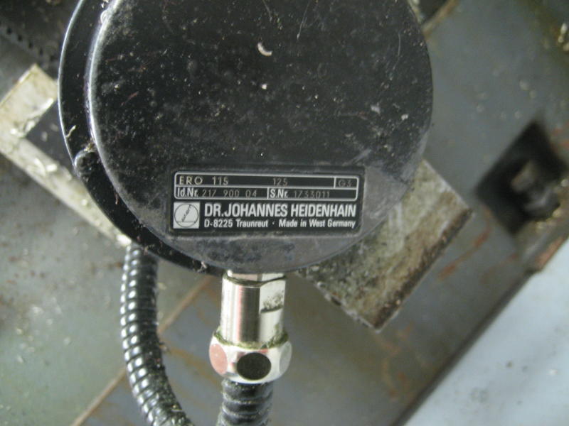

I have a BP Interact 412 that I am currently retrofitting. Does someone has the pinouts or pin descriptions for the Servo Encoders?
This is what I have below: Servo Motor and Pins for the Servo
This is what I need: A, ~A, B, ~B and Power Connections to the servo encoder
Thanks in advance for any assistance.

I was able to find the pinout for ERO115-XXX Encoders, source www.cncrotary.com
I hope this will help someone,
Joel

The stock Heidenhain Encoders are Sine Analog. So they will not work with most modern drivers. Also, the resolution was only 0.00033/inch.
I changed out the encoders with digital quadrature ones, not our resolution is 0.00025/inch.
You can see the entire build on the Mach3 Forum:
http://www.machsupport.com/forum/ind...c,13365.0.html
Hope this helps,
JH

The old encoders can't be just taken off, their integrated into housing. But if you looking for parts of the encoders like the lamp, encoder wheel, circuit board or the aperture housing, I have some of those parts left. If you looking for something specific, let me know.
