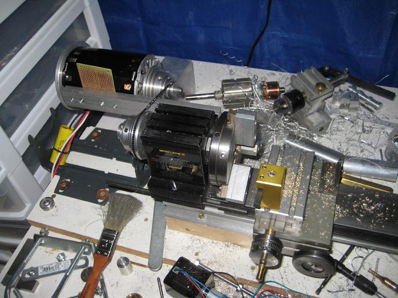

    I have replaced my Taig Micro Lathe II's motor from the Marathon Electric 1/4HP 1725RPM stock model to a new Marathon Electric 1/5HP 3250RPM.
    With the stock motor I could take max cuts of 0.005 and if I pushed the feed to max the motor would start slowing down.
    With the 1/5HP the motor is half the size but I swear its three times as powerful I actually tried to stall it and it would not let me! I can now take 0.015 cuts in AL and get a great surface finish and I plowed 0.050/pass and destroyed a 0.5in brass bar in a few passes and while the surface finish is not so wonderful a pass of 0.003 and it was nice and shiny again!
    I was using cheep chinese indexable tools from KMS Auto ($5 for the 1/4in tool holder and $1/HSS insert) and im very pleased with my results especialy given the fact the motor cost a whole $30. I'm going to pick up a few more of these that's for sure.
    The main problem is with normal use keeping cuts below 0.015 the motor does get quite hot and im worried about it, destroying that brass rod made is very hot indeed in a matter of minuets. I have been thinking of putting a plastic fan on the back and wrap some sheet metal around the motor as a duct but I'm not sure that will be enough. I want to keep it as low cost as possible but could pick up an old heater core from the wreckers for $10
    What do you guys recommend I do to keep this motor within its temp range??

    From the picture that you posted, it looks like you made a disk shaped plate to fit on the back of the motor to mount it. Is that disk blocking off the cooling vents at the back end of the motor? If so, that's your problem.

    TXFred: That plate is the stock 48N face mount. I might take it off and remove some material and make it spoked like a wheel so a fan can get the air moving through it.

    Well I know size is a big factor as well. The 1/4HP is vary large and god quite warm with heavy use but nothing to worry about. The 1/5HP is about a third the size and has the same 40c ambient and class B insulation rating but is very compact.
    Marathon Electric says these motors are $138 new to buy so i'm going to go into town tonight or tomorrow and pick up another one to keep on hand as a spare.
    I'm going to take the casing off this one and I'm hoping the field coils are in a harness or around a core that way I could get good air movement over everything. Ill post some pictures if I get it apart.

    This seems to be much ado about nothing! Just allow the vents that are already in the motor to do their job! If you are covering any vents, uncover them. If the motor is rated properly, it has been designed to cool with all the vents unobstructed. If you are not overloading the motor, it should be just fine. If you need to get additional cooling, add a forced air fan.
    Many motors are designed to run hot. using your hand as a thermometer is not reliable.
