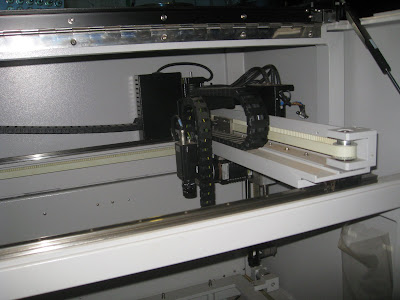

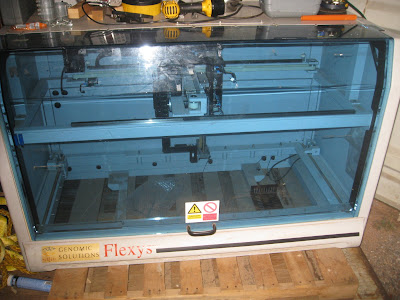

    A few months ago I found a machine at a surplus for $25 and just couldn't pass it up. It seem to be a 3 axis machine used for some medial research, but looked like it could be a CNC machine with just a little effort.
    The Machine is a a Genomic Solutions Flexys Robot.

    So I'm looking to get some input on how to convert the machine to a CNC.
    Here are some things I know so far.
    1. I haven't powered it up yet, the #1 PSU has a bad fan, and I want to fix it before I apply power.
    2. The stepper motors are driven by custom controllers using ST L6203 Drivers. Each axis has its own driver. Each driver is tired to a common serial bus and then back to the PC. I have PC software to test the machine once I get the fan fixed, but I'm sure there is no way to use the current drivers with Mach3.
    3. The Steppers motors are made by BERGER / LAHR
    X Axis is a VRDM 5910/50
    Y Axis - Cant Read the lable.
    Z Axis - VRDM 568/50 With some type of added module ?
    I can't seem to find any documents on these motors.
    4. The machine is driven with belts on all 3 axis.
    5. The Z axis has some rust on the rails, what should I do to clean these and protect them?
    6. Their seems to be a bit of play in the Y axis causing the Z axis to move slightly in the X-axis. Can this be adjusted?
