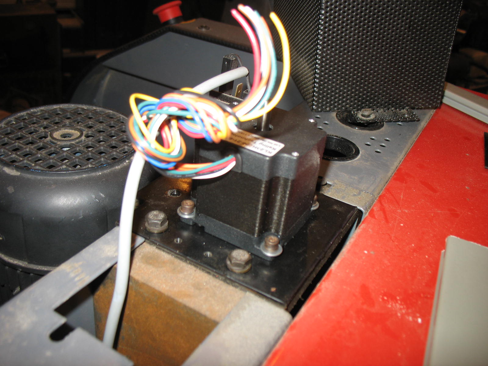

    We just picked up a nice PC Mill 50 this week- great shape but no computer and no electrical manuals. After probing connections and jerking around with it for a few evenings, I concluded that that spindle drive would be more trouble to interface to than it is worth and that the stepper drives require a square wave pulse train to be useful. Since the steppers are 5-wire, there aren't simple, cheap drives I can use to repower them. So... the retrofit will be done next week with 3 new Nema 23 steppers, Keling drives, an Automation Direct VFD and CNC4PC relay board for the spindle, and our Mach-based Touchscreen control system. Combined with the cost of the machine this will put our investment a little higher than I'd like to, but the final result will be an amazing bench-sized machine with better capabilities than originally equipped.
    We will be selling the spare motors, stepper drives, spindle drive, and motion control board (cheaply!). PM me if interested.
    I'll post an update when done.
    Steven Balder
    www.sbprecision.com

    Talking Mill done!!!!
    We got our parts and completed the mill refit. We used Keling KL23H256-21-8B
    stepper motors, Keling KL-4030 Stepper Drivers on the axes and an Automation Direct GS1-20P5 variable frequency drive and CNC4pc C6 board to control the spindle. We limited the spindle to 3000RPM and the axes to 50IPM, but tested them both much faster. Since the original ratings are 2500RPM and 29IPM we are very pleased.
    The motors were very easy to retrofit. We enlarged the mounting holes in the motors to fit the 50mm spacing on the original plates, and we took the original pulleys and ran a 1/4" reamer through them. Since I don't like to drill through motor shafts I tapped the holes in the pulleys where the original 2mm roll pins were to accept 3mm set screws.
    Here are some pictures......
    We have the mill listed on Ebay- http://cgi.ebay.com/ws/eBayISAPI.dll...m=190389549803
    Steven Balder
