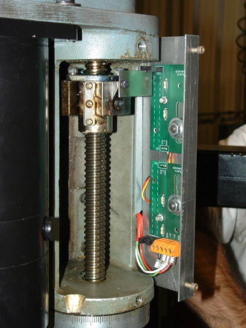

I am retrofitting a Bridgeport series 1 with an Ajax system, I have the optical Z limit and see that ajax has a drawing for wireing, but nothing on mounting them.

There are lots of ways of mounting them, depending on your quill housing.
Here is an installation on a Shizuoka ST-N, which required added sheet metal to expand the quill housing. Note that on this machine I installed them "upside down", to shorten and simplify the cable routing.
Just make sure you have a little room to adjust them up and down using the mounting slots, and that your wires don't interfere with quill movement.

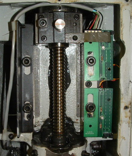

Here is a more typical installation, on a Supermax YCM-40.
Thanks that gives me something to work with I couldn't find anything on the Ajax site.

Cool
Now I get the jest, but am also curious as to if you could extend the connecting wires between the two and use them for the X Y limits as well?
Looks like it could work.
Machine_nut

You could, but they would have to be installed in a sheltered space. If they are out in the open, you will get a false limit trip as soon as a flying chip falls into one of the photo sensor gaps.
They are also prone to false trips if you let oil or coolant get onto the sensors.
In general, for X and Y you are better off using standard electro-mechanical limit switches. Among the many to choose from, I would consider the ABP2H35Z11 from www.automationdirect.com.
